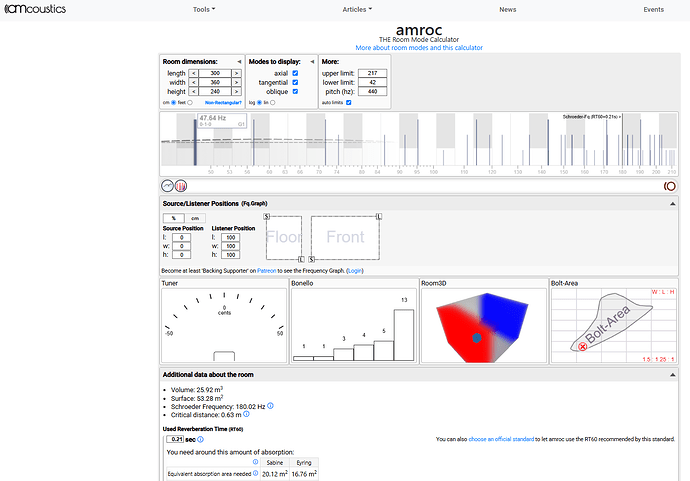

If you want to experiment a bit, I find the online tool AMROC really useful. It has taken me less that 6mins to see and read your post and create the picture below.
PS: I took the liberty of entering your room dimensions (estimating height at 2.4m) and have not entered your listening position, so you could have a play with that if you want.
Here is the screenshot of the tool in operation for your room dimensions.
Copyright AMcoustics.
Be right back. Just need to get my masters degrees in physics, engineering, and geometry so I can make sense of this :grinning_face:
