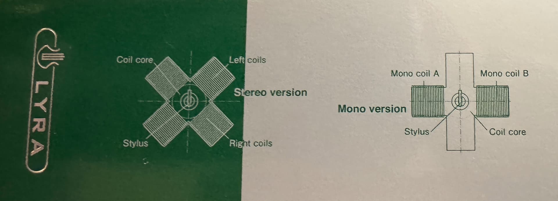

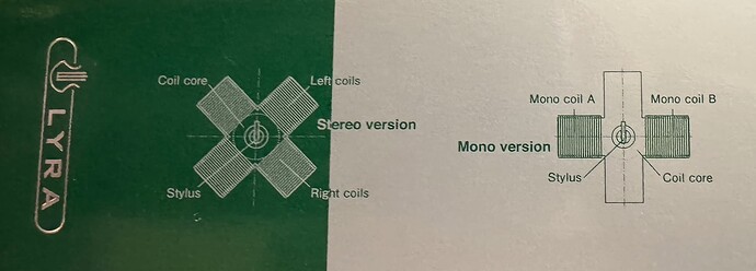

That’s not correct. The Lyra Atlas Mono I have has two coils, and it is indeed a real mono cartridge. It’s just that the coils are oriented as mono to ignore the vertical groove signal. You get identical output on both channels so that you can use a real mono signal in a two-channel system.
Here’s an image off the box to show the difference.
In this case the two coils are acting as one big one in the horizontal plane so that is indeed a true mono cartridge.
