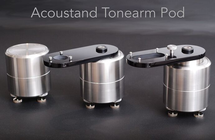

Or additional arm with an external pod.
Well I’ll be go to hell! That looks very interesting . Do you have any experience with this ? I think some research is in order. I’m wondering how fussy the set up would be?

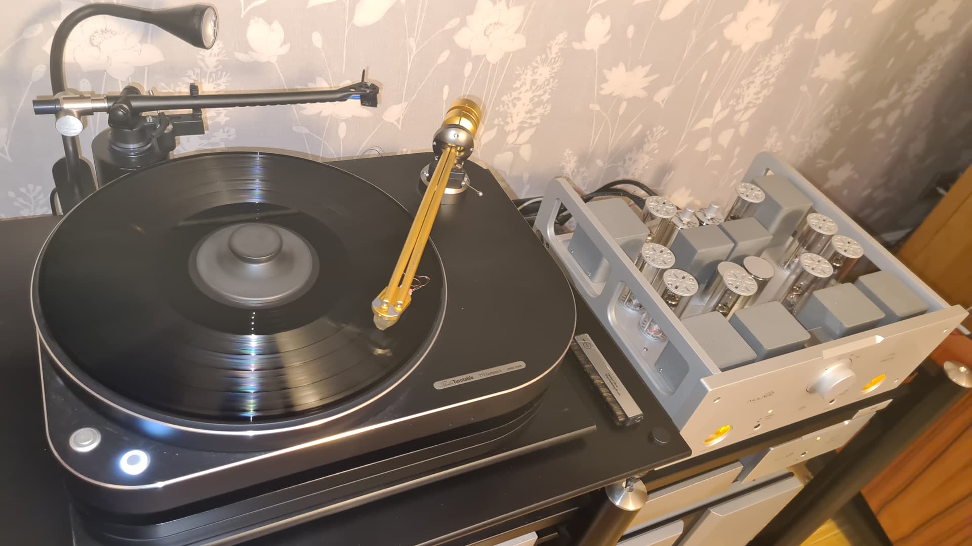

“. That’s about it, love have 2 arms as the exquisite sounds wonderful, and pulls far more out over the windfeld, but it can be too much on some pressing, that’s when the windfeld steps in.
Plus it’s as eady as just turning a know to select input 2 on the phono stage.
Love my vinyl when in the mood.
Cheers dunc“
@Skeptikal , the Lp12 specialist. Do you think an external pod with a second arm would work with an Lp12.
Maybe Richard too, as he owns a several dozen of turntables.
It won’t work well FR as the Sondek has a sprung subchassis. Any second arm would need to be on the same subchassis.
I’ve read one and only one discussion on the pod so far. Due to the fact the LP12 is a suspended table it will not work. That makes sense.
Thanks Richard! Saves me some sleuthing.
Thanks to @Mandrake and @Richard.Dane
You saved me some typing.
@frenchrooster
Sorry mate but it’s a no. :-1: :wink:
Same foundation required.
As your lp12 doesn’t appear in your profile, I searched through your activity and discovered it was an lp12.
So bad news, it won’t work.

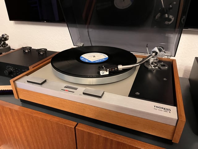

Thorens 125 , as second tt for mono lps?

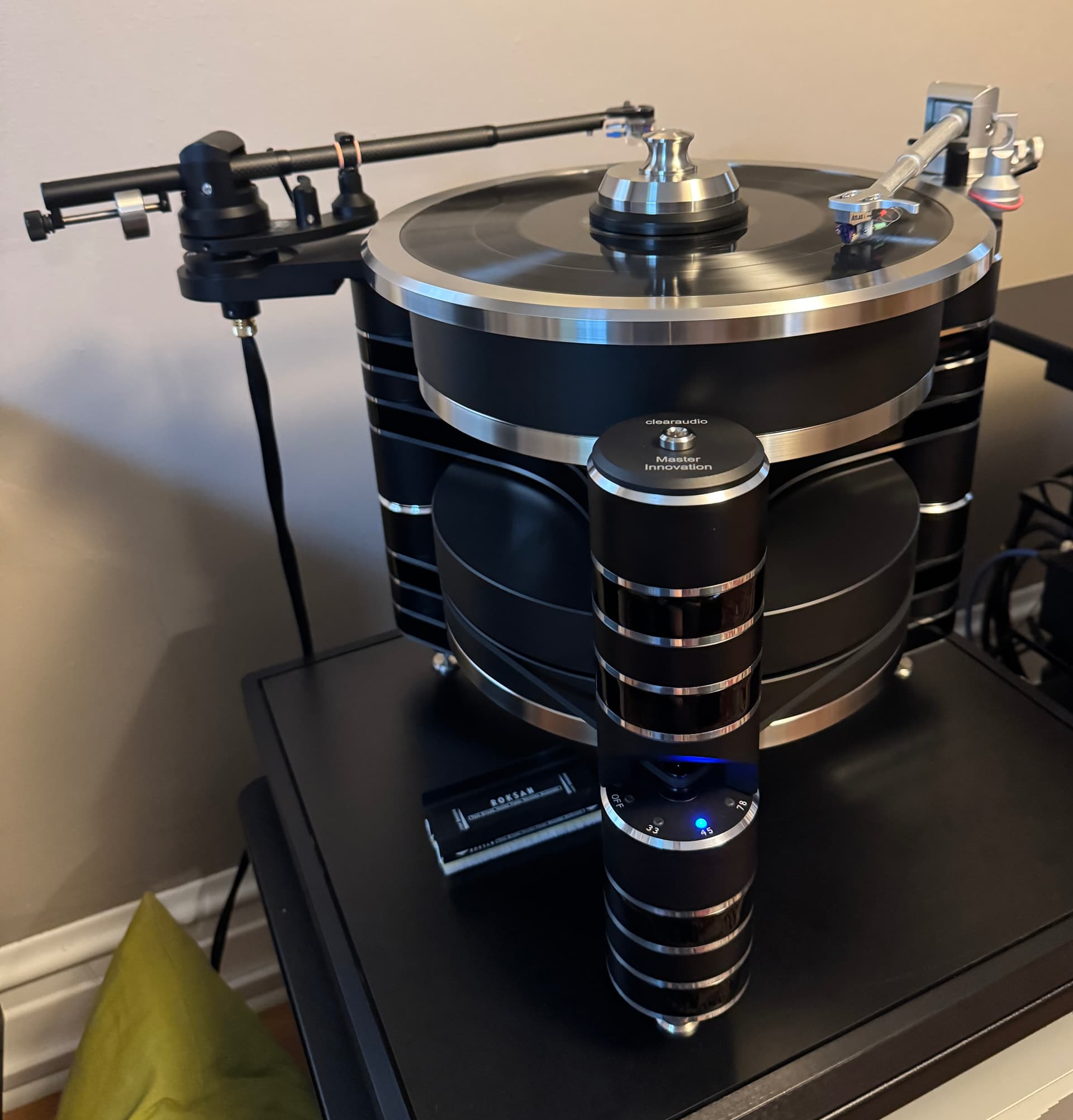

@JosquinDesPrez has 2 arms, with one Lyra Atlas stereo and a second one Mono. His very modest turntable, a Master Innovation by Clearaudio, accepts two arms.
Do you have 2 imputs on your phono?
All the Innovation series accept two tonearms. However, the Master Innovation I have is a little different in that you can add a third tonearm. Unlike the other Innovation turntables the third pod does not have the speed control at the top, so it will accept a tonearm base instead. I’m thinking about adding a 9" Tracer arm to use for my Dynavector and Koetsu cartridges (with a Boulder 508 for it).
But, yes, I have two tonearms with the mono and stereo versions of the Lyra Atlas. It’s a good idea to have a phono-stage with two inputs. If you think you’ll just swap cables to a single input going between mono and stereo playback, you end up in ‘mono’ or ‘stereo’ modes for listening, rather than just playing records ad hoc and selecting the appropriate tonearm and input as you go. I used a Superline for both tonearms previously and I grew quite tired of reaching behind to swap cables all the time. That’s why I changed to a Boulder 2-input phono-stage.

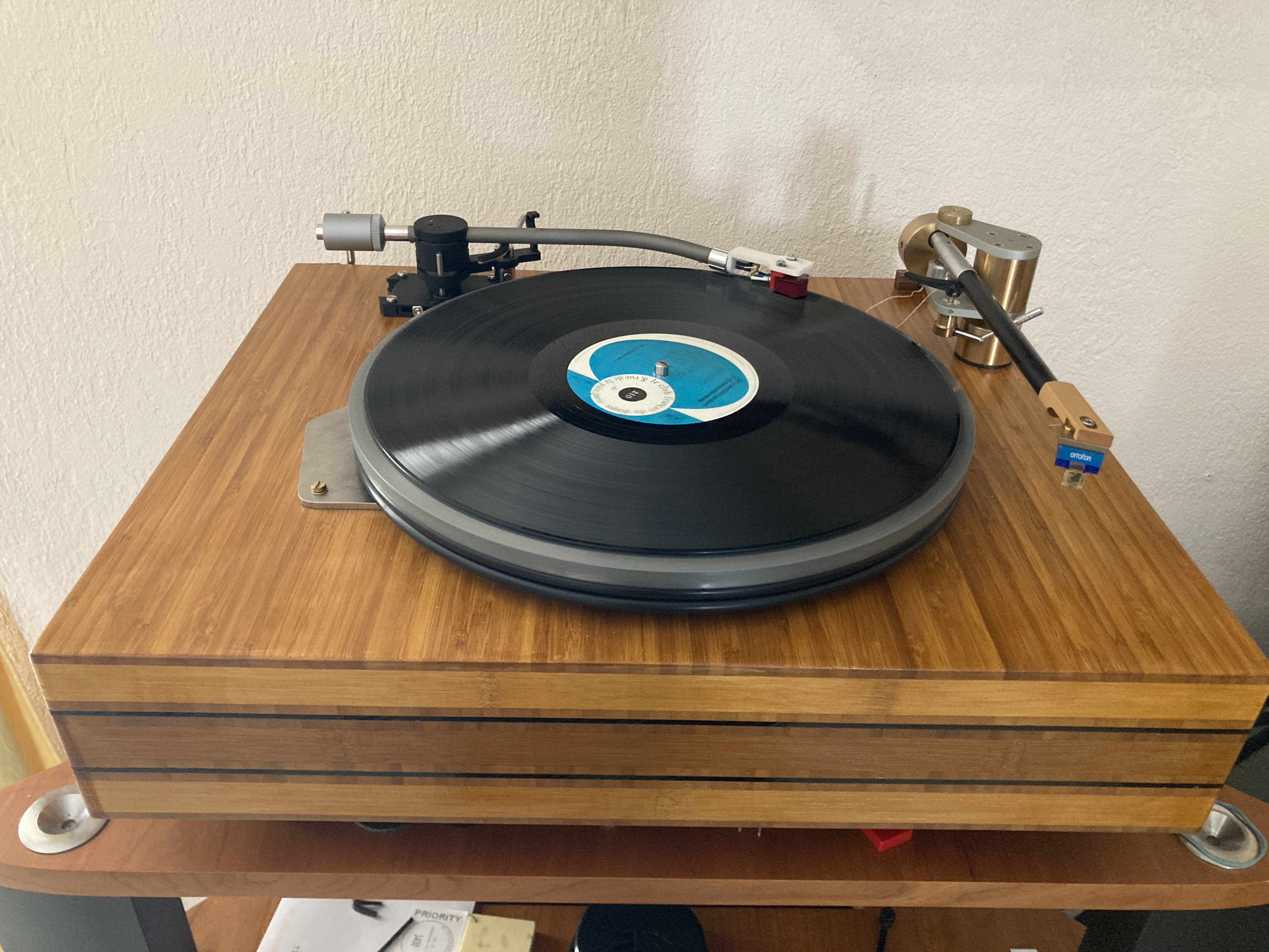

The Decca Maroon is the mono version run into a stageline N powered from the 552. The SPU Royal N has a Replicant 100 stylus and plays into a supercapped superline. On original 1950s mono discs it earns its place but on modern reissue mono it’s more a different flavour than better, though many still played on it rather than on the SPU.
The deck is a Lenco L75 with PTP bearing and top plate in a home made bamboo and polycarbonate plinth.

I made my own tonearm pod, and on its 4th reincarnation now, just to tight to buy one, plus i could make it.
