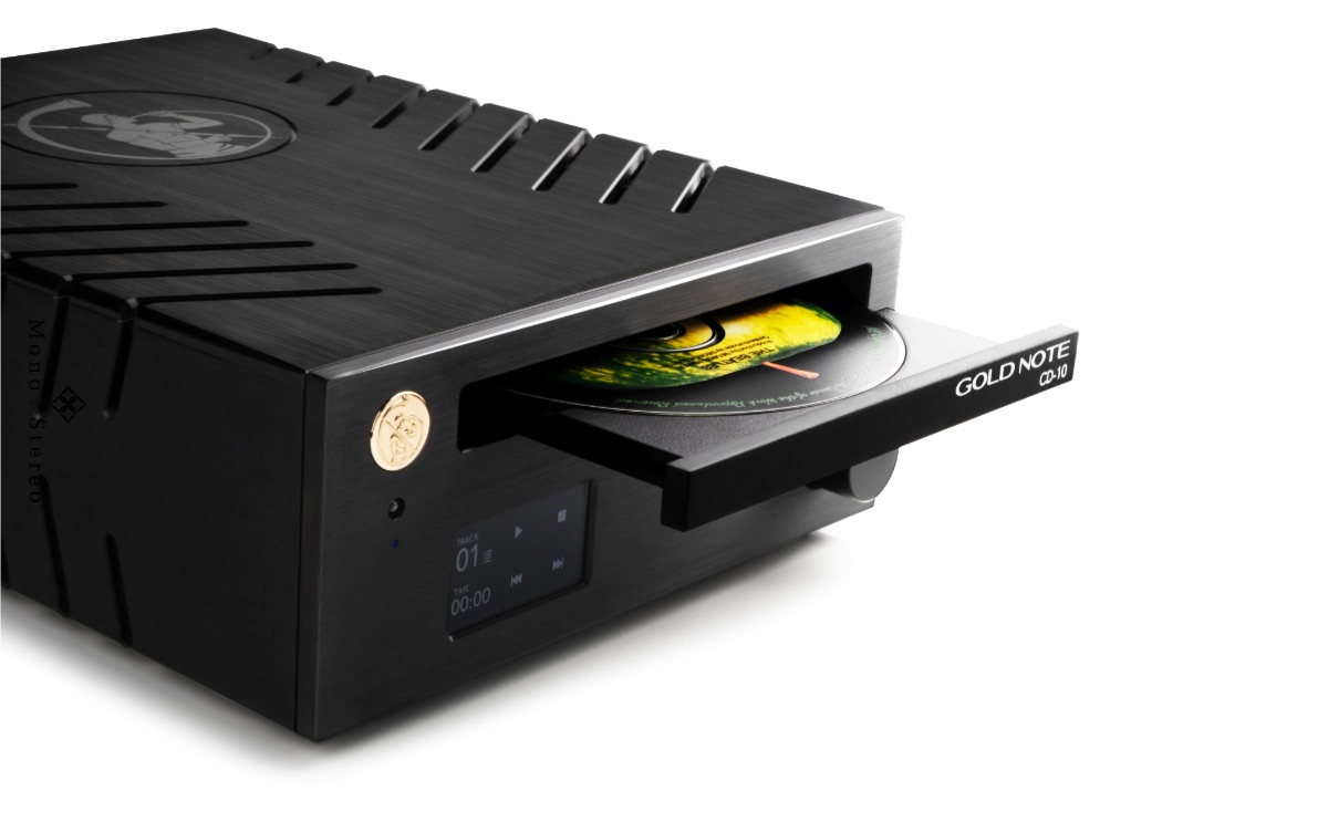

I rip in WAV because Naim & my dealer say it’s best. Dealing with any transfer should my Core become unusable I’ll probably buy a CD player. The Core is fantastic, I love everything about it but I would have bought a CD player or CD transport if Naim had had a genuine replacement for my CD5xs on offer when that failed. Trouble is the non Naim CD player replacements I see either don’t have the build quality of Naim or are the size of a small bungalow. Ah well, hopefully the Core sees my time out. I expect the first thing to go would be ripping (?) so playback might have a better chance of survival. Playing my own (ripped) CDs is so much more involving, for me, than playing streams.

That certainly meets the size criteria, so thanks for that. I don’t need one just now, hopefully never will (although I may weaken at some point, you never know I suppose). The Core sounds better than my CD5xs/Flatcap 2 did by some margin & my dealer says it sounds better than streaming so I’m perfectly happy. Tbf I can’t tell the difference between ripped/streamed on my relatively modest system. I just can’t imagine ripping 3,000+ CDs again ![]()
