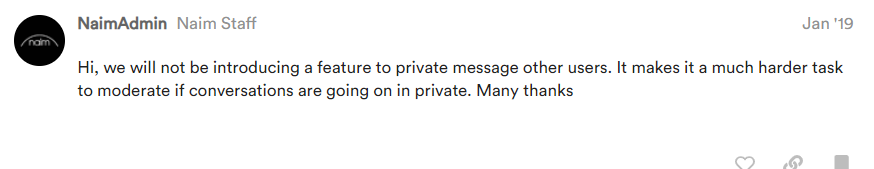

Private message me. I might be able to help with your existing WiFi gear rather than you going to the expense of buying a new router when there may be no need.
Hi, Thanks - I’v been searching PM button.. and finally found this:
