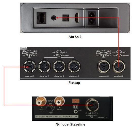

Why not stay with Naim? - Stageline N is considered now as a separate phono pre-amp for turntable. Now, here’s where the story begins. Stageline has 2 DIN outputs, 4-pin and 6-pin, if I see it correctly on the pictures. Is there any meaning of looking for 4-pin DIN male to 3.5mm male connector, to wire together Stageline and Mu-So V2?
I also consider of adding Flatcap as a separate PSU for Stageline. And I’m confused now by possible line up and wiring…
Additionally will Mu-So’s internal amps and own speakers be enough to enjoy vinyl records processed by Stageline?
My proposed line-up is attached, so please criticize and advise if any better options are available.

Hi Kamran & welcome to the forum.
You would maintain correct earthing by connecting the audio out to the Mu-so via one of the 4 pin DINs on the Flatcap.
The 4pin DIN on the Stageline was added for i-Supply users, as there is no other audio out option.
Regards
Neil.

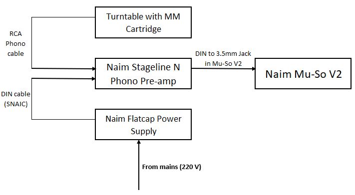

So, if I understood you correctly, then the newly attached picture shows correct line-up? (see below)

If your budget will stretch to a Stageline and Flatcap plus a turntable worthy of feeding it, I would suggest that you will get more from it if you use a proper stereo amp/speaker combination. The Muso will work just fine, but if your dealer is any good, he should be able to demo some different systems so that you can make an informed decision.

Hi Kamran,
No, you’d need to use one of the sockets labelled “signal out A, B or C” (A being the shortest signal path) to feed the Mu-so, if you are using “power out A” to feed the Stageline.
Regards
Neil.
