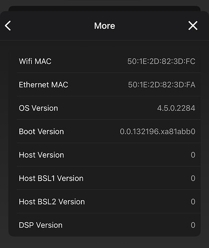

The DSP Version should be displayed via the “Naim Focal App” which is V8.0 on an iPhone.
Select the top right corner settings icon, then
Information & Help
About
More
- DSP version should be the last field,
Thanks! This is what I found there, and I believe it confirms my assumption that the DSP firmware is missing. It’s a pity I haven’t received any response from Naim support yet — a bit disappointing, to be honest.

  4. In the Naim app “More” information screen, the following versions were shown:
    • OS Version: 4.5.0.2284
    • Boot Version: 0.0.132196.xa81abb0
    • Host Version: 0
    • Host BSL1 Version: 0
    • Host BSL2 Version: 0
    • DSP Version: 0
  5. The device was able to enter Update Mode via Web
