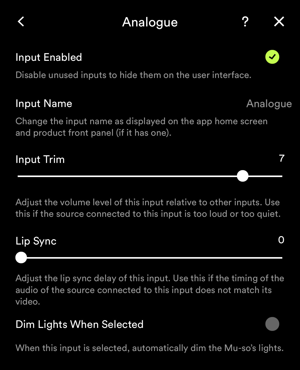

In the input settings of the app you can indicate, for analogue input, 3 input level options. Default is 2V IIRC, maybe try to set to 1V and see if with your first option that sounds better?

That was a great tip, @Igro. The setting is not quite how you described it (see attached screenshot), but the result is the same: gain boost!
