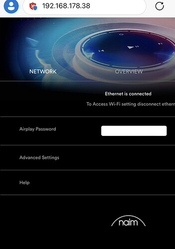

Try visiting the muso IP address in a pc browser, and checking the network page. That’s where you can store the airplay password if it’s needed, or reset it.

Hi Robert, I tried access the Muso’s via ip address as you suggest. I was able to set a passcode and when I tried to connect the Muso from Apple Music I got prompted for the passcode. I entered it. This made no difference. Sigh.

Did the IP address in browser ting. Did not work out.
