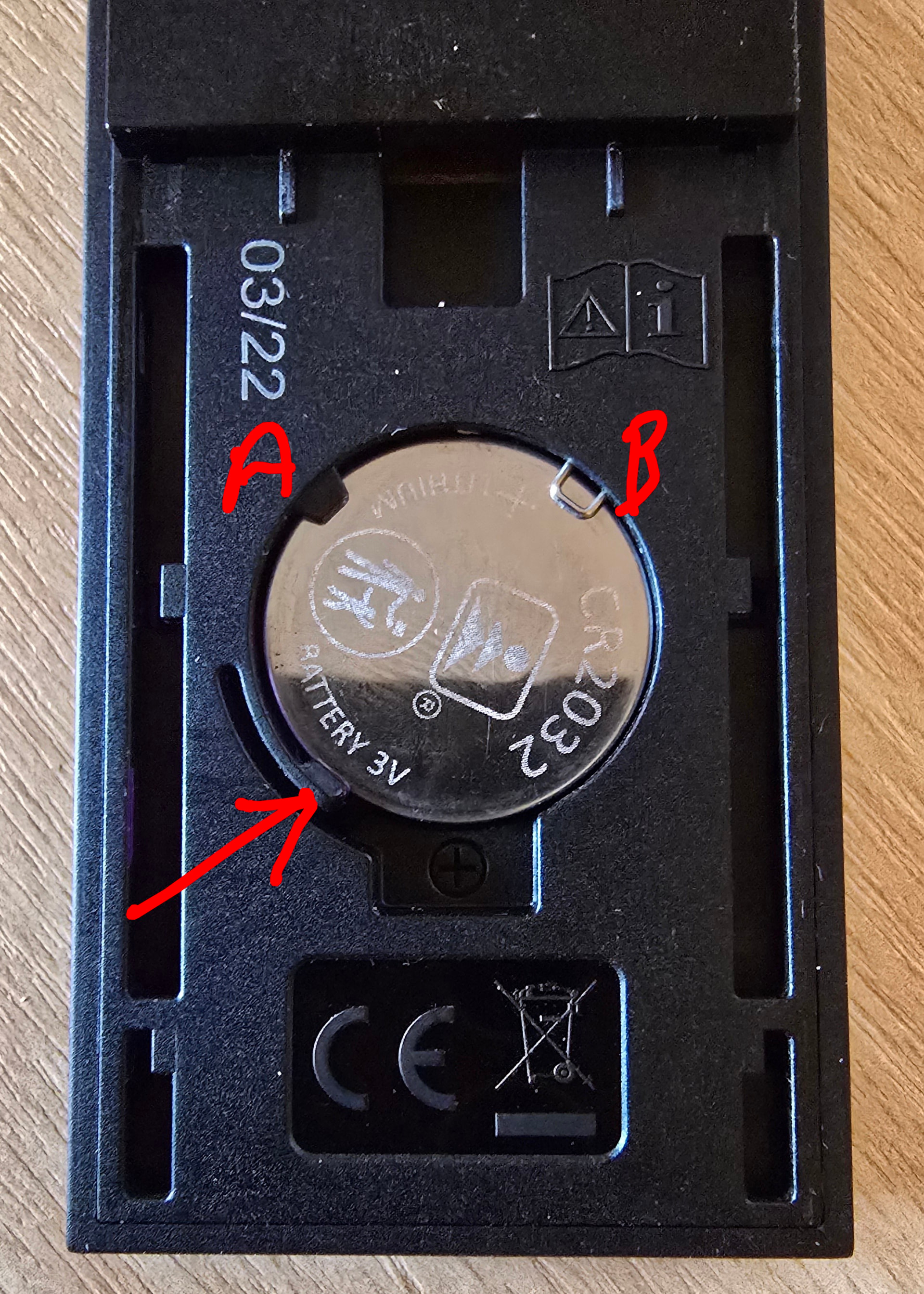

How on earth do you remove the battery from the QB2 remote? There is a small retaining clip where the arrow is and pulling that back let’s the battery pop up a little but the parts indicated by A and B hold it in place when trying to slide it out. I don’t want to force it in case I break it. Surely there must be an easy way to do this but I can’t see it!

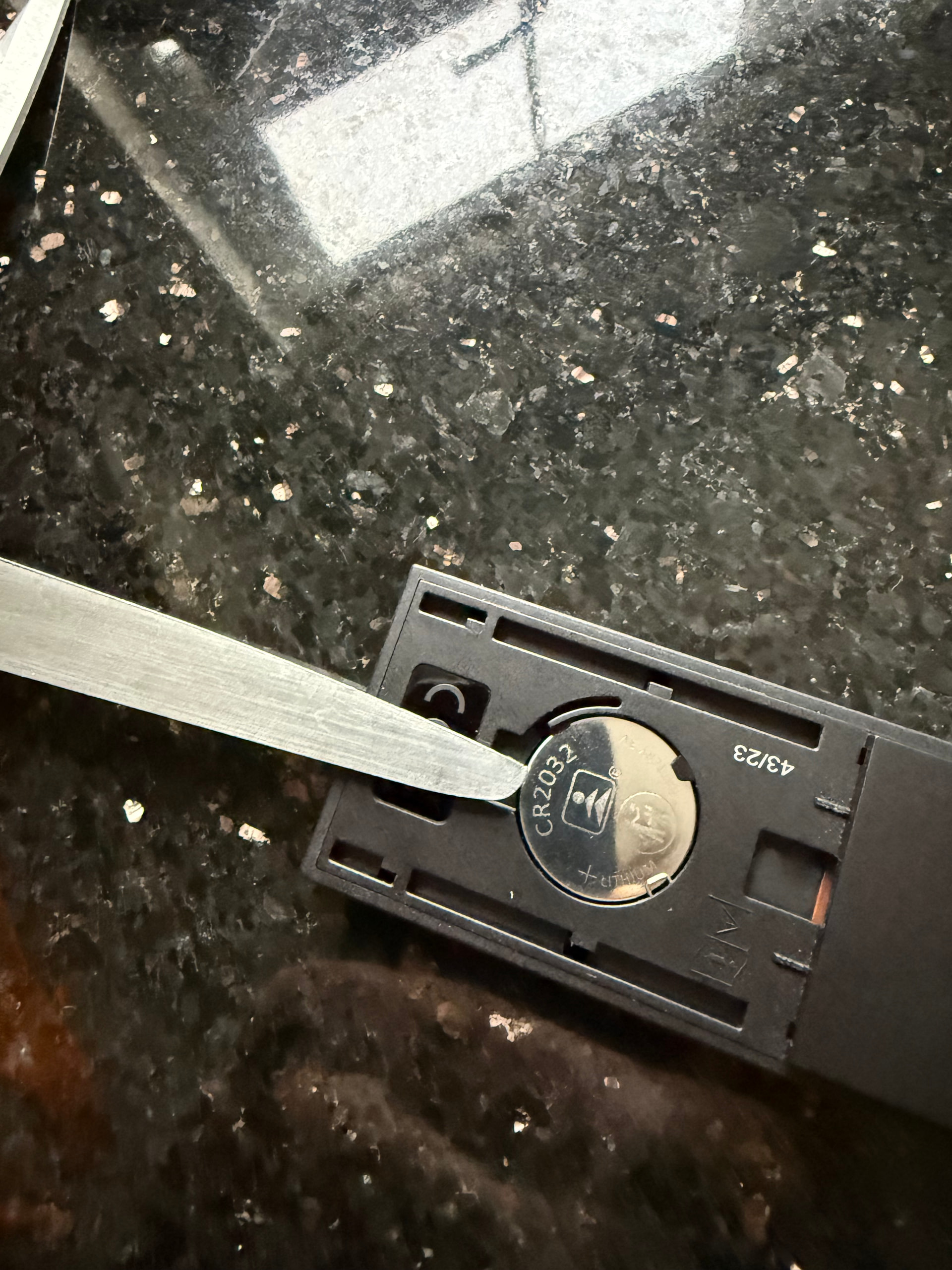

Poke the scissors under where indicated and it will pop up.
You just lift the edge that has popped up a bit more and you will be able to slide the battery away from A and B and then lift it out. You put in the new one in the reverse way. It’s easier to do than to explain!

Others have said how to get it out, a small micro flat screwdriver may prove easier than scissors. Make sure you fit a decent cr2032 battery, I’ve found Panasonic good for other applications.
Small flat screwdriver did the trick but it was still more force needed than I was comfortable with :slight_smile:
