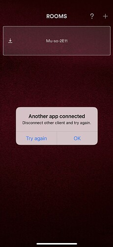

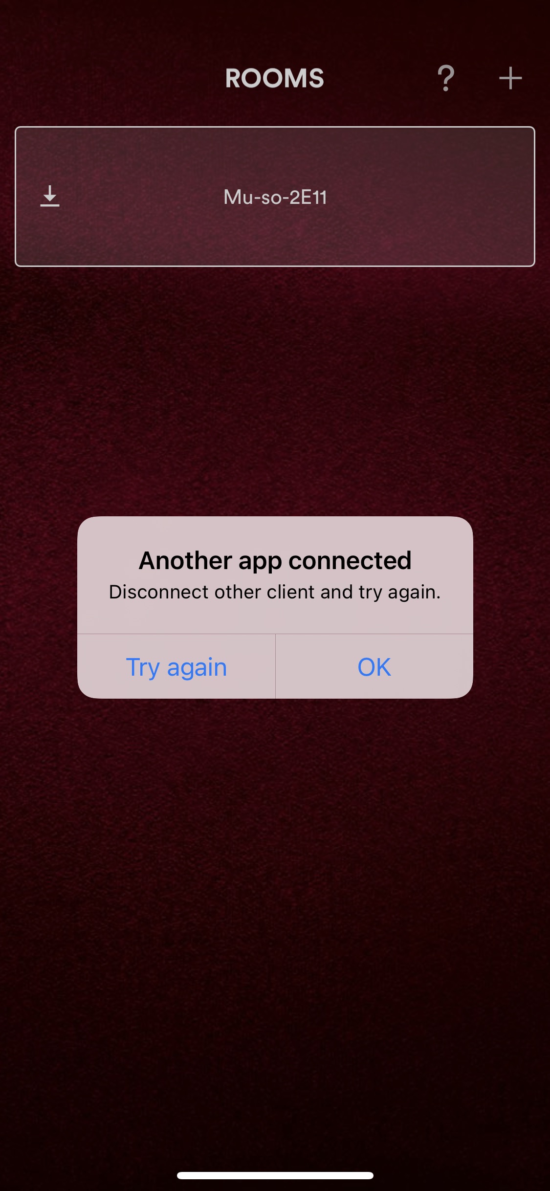

Also, my Muso has never been able to fully utilize the iPhone app. I would get this message after selecting it from the room screen:
I used it primarily as a sound bar, so it didn’t bother me, but wondering if this failure mode plays into the situation.
My QB on the same network does not have these issues, and the app is fully functional with it.
