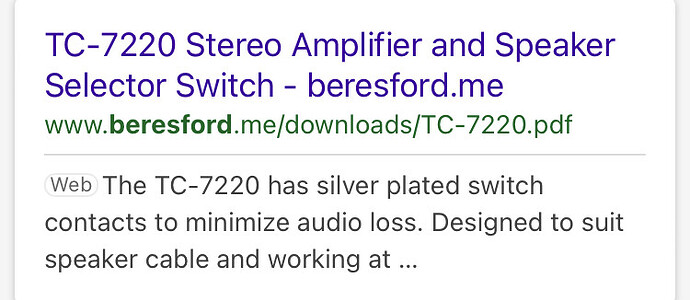

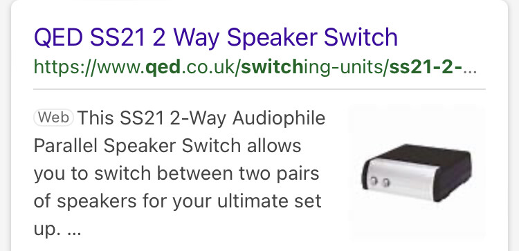

Can you recommend a speaker switcher? I want to have the control of which speakers are on.

Hi and welcome. I tried this once with a QED and frankly it didn’t work very well. Firstly a switch box clearly compromised the sound in both rooms but more the volume setting in one room will not be what is required in the 2nd. I have found that a better solution is a Muso in the 2nd room. Sorry!
