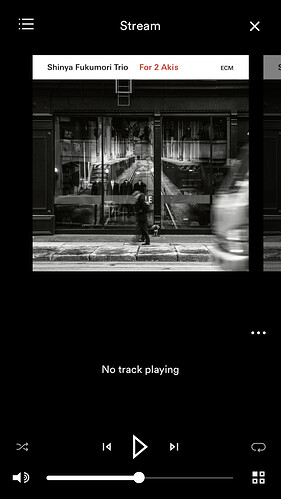

You need to touch the four little squares in the bottom right hand corner. You may also have to enable the multiroom input on both streamers.
It should be simple to use multiroom between any two Naim streamers, and with the current range that includes all inputs. Is the multiroom button not visible, as in the screenshot posted above by HH?
For clarity, perhaps I should mention that the multiroom buttons only appear on the “Now playing” screen.
It certainly is possible, as described above. When playing on the Star, press the bottom right square symbol and select the Atom. Make sure mulitroom is enabled through the app for both devices.
