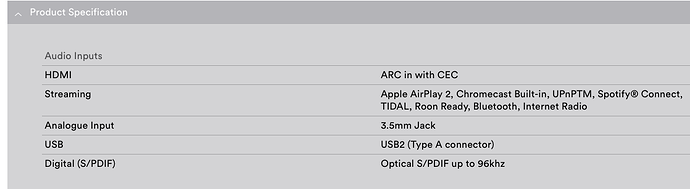

Has anyone ever successfully connected HDMI output from a Mac (e.g., MacBook Pro) or a Raspberry Pi to HDMI input of a Muso?
Shouldn’t this be possible?
In my case several MBPs and RPi5 utterly fail to recognize that Muso is connected (known good cables).
The Muso HDMI input is not completely foobar, audio from TV’s HDMI ARC plays fine.
They are HDMI ARC inputs for taking the Audio Return Channel from an HDMI ARC input on a compatible TV or Soundbar. Connecting to a regular HDMI output from a source such as a DVD or Blu-ray will not work. For those you will need to connect via s/pdif.

That’s what is odd about the situation, Naim seems to be very coy about having HDMI audio input (same as USB), is is not at all what one would reasonably expect. Per [HDMI - Wikipedia]:
Audio return channel (ARC) is a feature introduced in the HDMI 1.4 standard.[41] “Return” refers to the case where the audio comes from the TV and can be sent “upstream” to the AV receiver using the HDMI cable connected to the AV receiver.[41] An example given on the HDMI website is that a TV that directly receives a terrestrial/satellite broadcast, or has a video source built in, sends the audio “upstream” to the AV receiver.
Hardly anyone builds computers with HDMI input so there is no “Return”.
Authoritative response from Naim and/or clarification of the specs would help.
