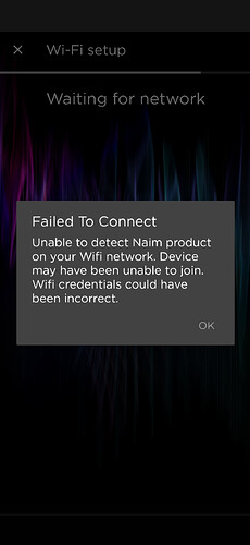

OK, so tried a resent. Qb has gone from status Orange → Purple → flashing Purple → White (with requested inputs from myself). Once more it is showing in the windows network.
The app went into a Waiting for network and now, after a few minutes, has
Anyone any thoughts on how to resolve this?

Sounds faulty. My Muso2 has been back twice for a new wifi module thingy.
Even when it works, it often disappears from the app, requiring a hard restart.
When it works it is great, but I’ll not be buying another.
My ndx2 that is in the same room and further from my router never drops the WiFi.
Id suggest yours is faulty so return it.

Just to check but do you have any WiFi extenders etc?
The BT hub is wired into an Ethernet backbone. There are an additional four access points connected (all hardwired) to that (old house thick walls). They’re all set to the same SSID and password, works seamlessly.
What appears to be happening is that when my phone is on the same access point as the QB the app can’t find the QB. If I move to a different part of the house and the phone transitions to a different access point then the app connects to the QB. If I then move back to the kitchen then the QB gets lost.
Willy.
It’s possibly a setup issue with the 'access points, it may be worth checking this.
It’s not the the App can’t find the QB but that the Qb’s discovery announcement is being blocked.
Well try a reset on the access point and see if that helps.
Willy.
Looks like the Access Point is on it’s way to that great network in the sky. Have hardwired the Qb (the sockets and cables were in place as part of the kitchen build, I just needed to patch them in in the attic) and it’s been behaving itself for a few days now. Replacement Access Point ordered.
