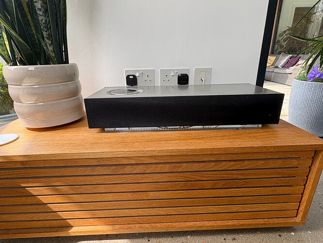

Muso (Gen1) Dead
Well, my much loved Gen 1 Muso appears to have given up the ghost. No power/lights at all, fuse changed, all connections checked etc.
Anyone else had this problem ?
I wondered if there was an accessible internal fuse that could be blown, but from what I gather there is not. I would imagine a Naim repair (if they still do that for Gen 1s) would be prohibitively expensive.
It has served me very well for 13 years or so, so I guess I shouldn’t grumble too much, just wincing at the cost of a replacement.
