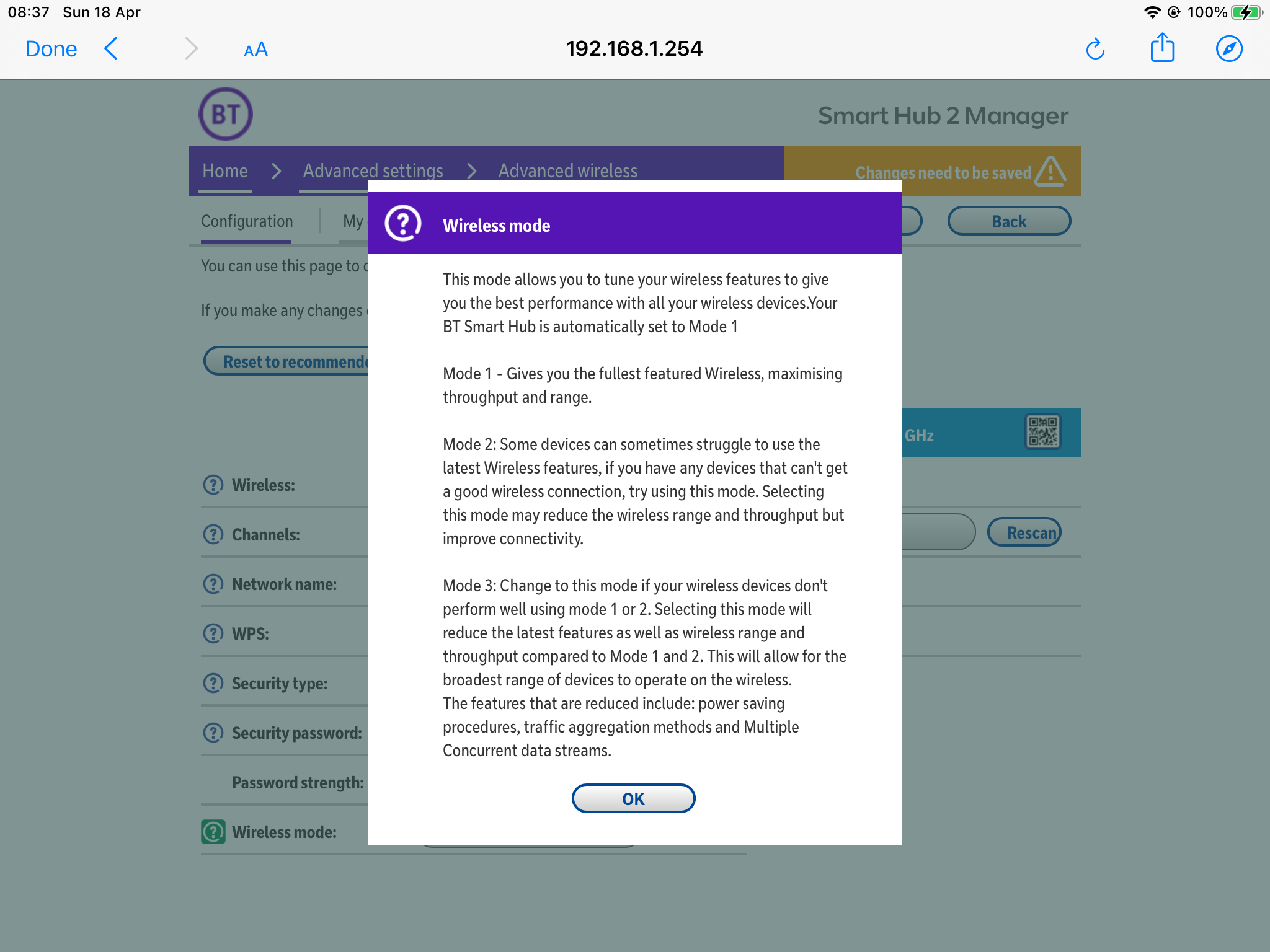

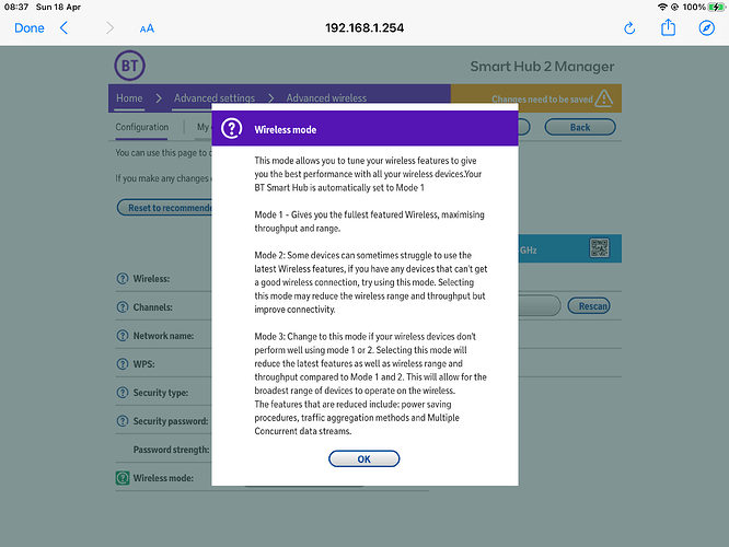

BT offer a compatibility mode in their wifi setup for troublesome devices, have you tried using that?
Try mode 2 first and if no improvement then mode 3
If still no joy, try switching off the 5GHz radio… however at this point I would suggest using Ethernet instead…as that will impact the effectiveness of your wifi.

Have you tried the BT Smart Hub wifi compatibility modes for ‘problem’ devices?
It might be the 272 struggles with the latest wifi power saving methods.. in which case mode 3 might work. (I have a suspicion this is your issue)
Thanks Simon will certainly give that a try.
I’ve changed the wireless mode, powered everything down. Checked the router is still in mode 3 after the reboot and it is. Brought everything back and I have a connection. Off out now for a few hours so fingers crossed it will be there when I get back.
