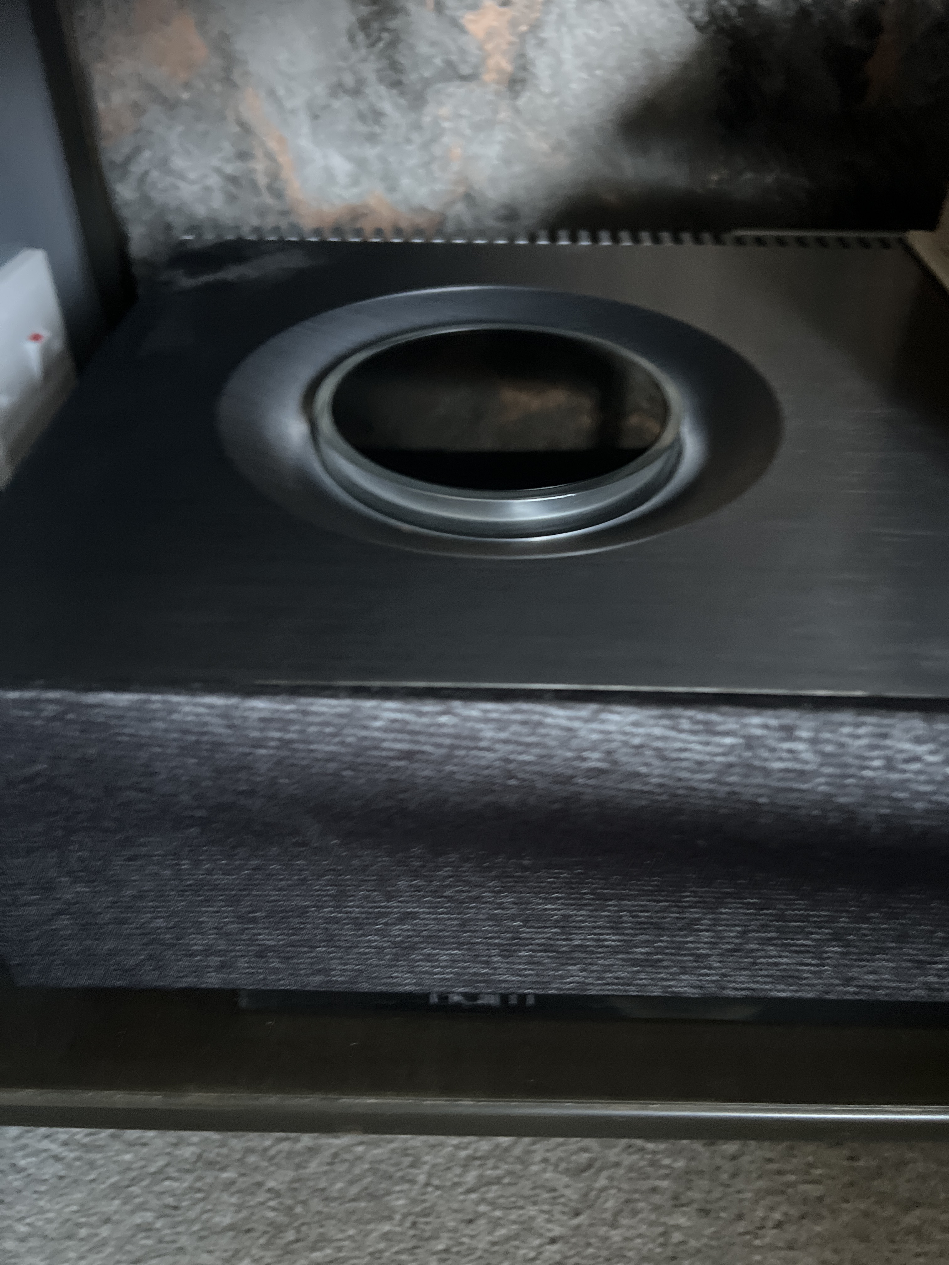

My Mu-So speaker will not switch on having not used it for about 5 weeks
I have not used my speaker for about 6 weeks and it has been plugged in all the time , I came to use it yesterday and it’s totally dead I have unplugged it for 30 min pressed the rest button and nothing
