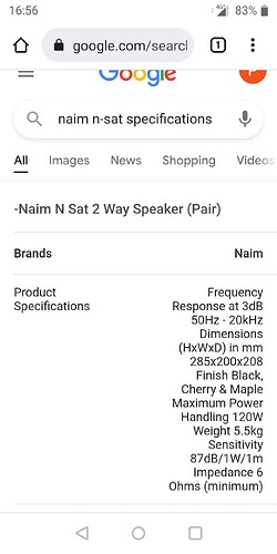

FWIW, IIRC Naim quote 6 ohms as the minimum impedance.

thanks very much. I now don’t actually need an impedance/phase graph because knowing that the Sats are 6 ohms minimum is enough information for me. I can more or less desume its behavior as an electric load from that single value.
