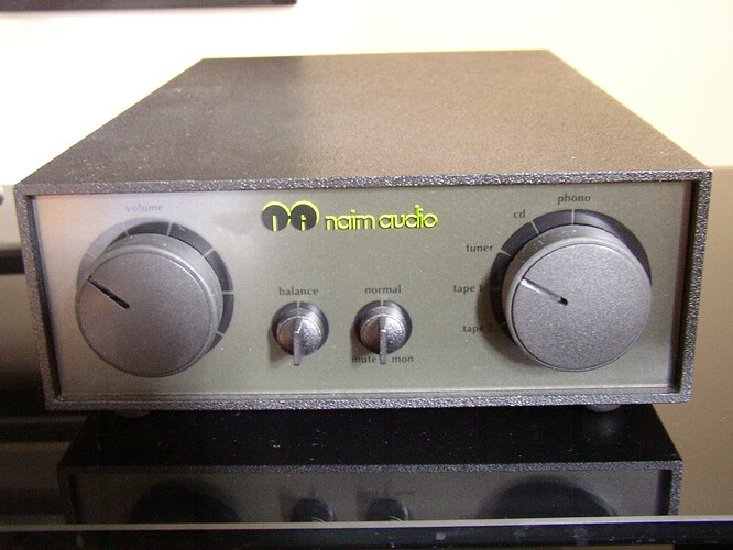

I have now added a hi cap so will let you know how it goes after a few weeks of listening. I’m not too clear about the connections ? I’ve plugged the snaic 5 into port 4 on the hicap but on the nac102 instructions it mentions plugging port 3 into the power amp?
Anyone shed any light on which is correct?
Yes that’s right. Hicap Socket 4 connects to the 102. Socket 3 connects to the 180.
Thanks James - where does it go into the 180?
The Op’s experience mirrors mine. The 102/180 are forgettable. If you want to stay with the olive boxes go 72/HC/250 and don’t look back. If you want more modern kit go with the SN2 or SN3…
The DIN4 input socket. You only have the mains socket, two sets of speaker sockets and the input socket on the back panel of the 180.
So I need to unplug the 4 pin from the nac 102 output 4 and put it in hi cap?
Yes.
Thanks James all working.
Can anyone explain what the hicap does in this configuration ?
It’s powering the 102 with two 24v power rails rather than the single 24v rail that the 180 can supply.
Naim connect to the power amp via the power supply, hence why you now have the 180 connected via the Hicap rather than directly to the 102.
