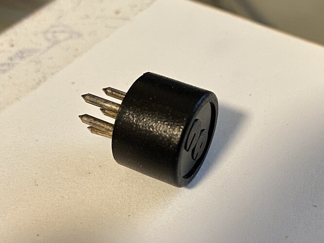

Is this the link plug? I have one and I no longer have a 282. I sold mine to the same person who bought my 250, so it sounds like I should send it on to him so he has it. He got the paddle link plug and the AUX2 blank plug, but not this one.
