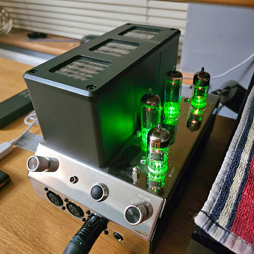

Many will say a dedicated HPA is not necessary and that cans are easy to drive and require little real power. Or perhaps I have been spoiled with first a Violectric HPA281 and now a Mcintosh MPA200 - both great HPAs albeit at significant cost.
Something to whet your appetite….
Definitely. The Stellia is a very detailed and dynamic headphone, in fact a bit too much for my tastes. You really would be best auditioning it with the HPA of your choosing. I can imagine some may not be good pairings, independent of bring able to drive them effectively.
