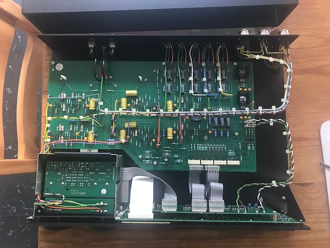

Here is a pc of my NAC82, sans cards here.
The 5 series Phono cards go top left - onto the 4 Gold pins and the White post.
(To release the cards from the white ‘post’ is just a matter of gently squeezing the post’s lugs, while gently lifting the card.)
