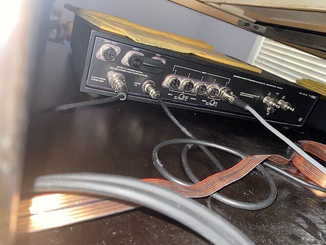

Hi. I tried to directly connected from Nac 82 to Nap 180 through the tutorial of naim. Right now, I don’t have Hicap, and the system is not able to play any sound. Would you guys please tell me the problems and how to fix it? Thank you so much.
Do you have both plugs in place, one single plastic and one dual plastic plugs?
Under neath those you then need the napsc plugged in as well as the 180 connection.
Hi,
the connection system is connected as follows: The snaic 4-4 cable, the leftmost cable directly connects to nap 180, and the rightmost cable is connected to the naim 2 rca to 5 din cable. DAC Yggdrasill to nac 82.
Thank you so much.
You seem to be missing the link plug for Upgrade 1.
Yup. As it is, it wants a HiCap…!!!
Could you please explain it more specifically, like how to upgrade it to “Upgrade 1”? I’m new to this, so I’m mostly very clueless.

As Richard and Bruss have said you need both link plugs in when just using the 180. It’ll work fine this way without the Hicap.
You are missing one in the Link 1 socket

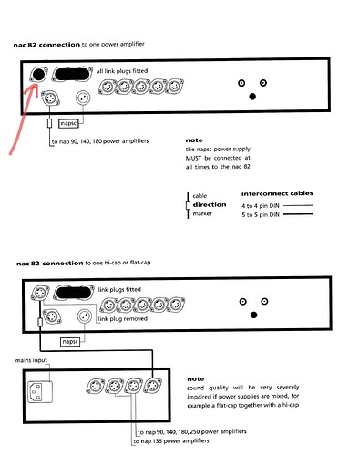

I believe it’s one of these:
James, do you concur?
Yep ![]()
Cool. Hopefully Richard will let the link remain on this occasion.
Erm… close. Not for a 32 - only a 32-5 - and for a 42-5. Otherwise OK… ![]()
Good point; somebody better tell Tom Tom.
