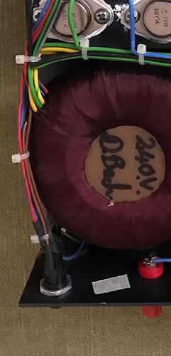

This is how my Nap 110 with Bulgin looked inside.

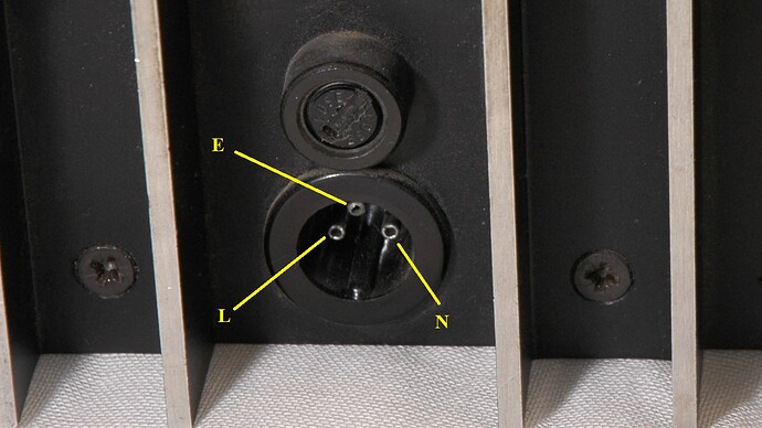

These are the pin allocations looking from the rear of the unit:
Regards
Neil.

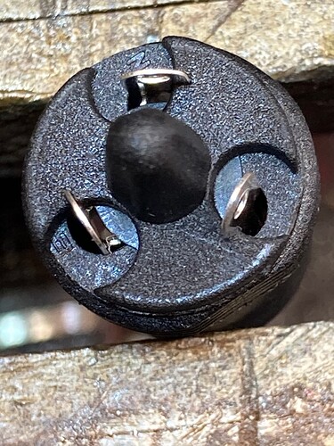

Thank you for all the responses. It transpires that the plugs are actually marked but you need a torch and magnifying glass, or a phone camera on full zoom, to make them out.

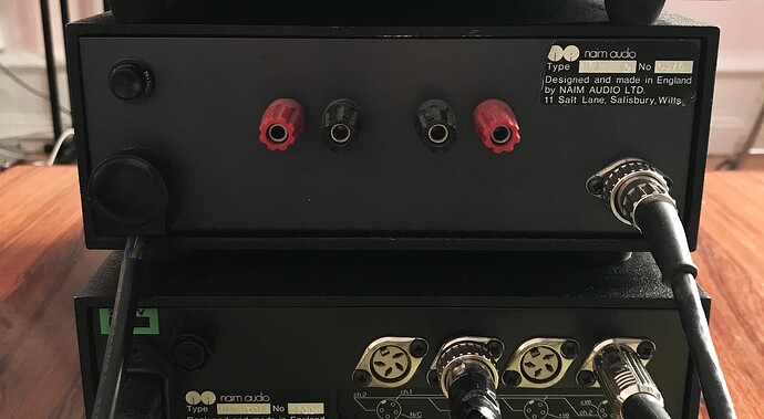

I have a Nap110 with Bulgin Wiring.
Regarding your main lead from Custom HiFi Cables
Could you describe more details about this cable?
Thanks.

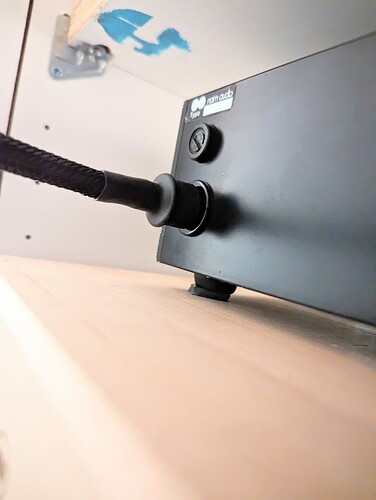

Yeah, who knows. It was the first time I’d ever seen such a thing. Mine (both the OG and the new CHC one) fits pretty damn tight, much tighter than any modern IEC I’ve had on Naim or other electronics
Here’s a quick pic around back. You can see it’s a more substantial connector than the OG one, imo.
