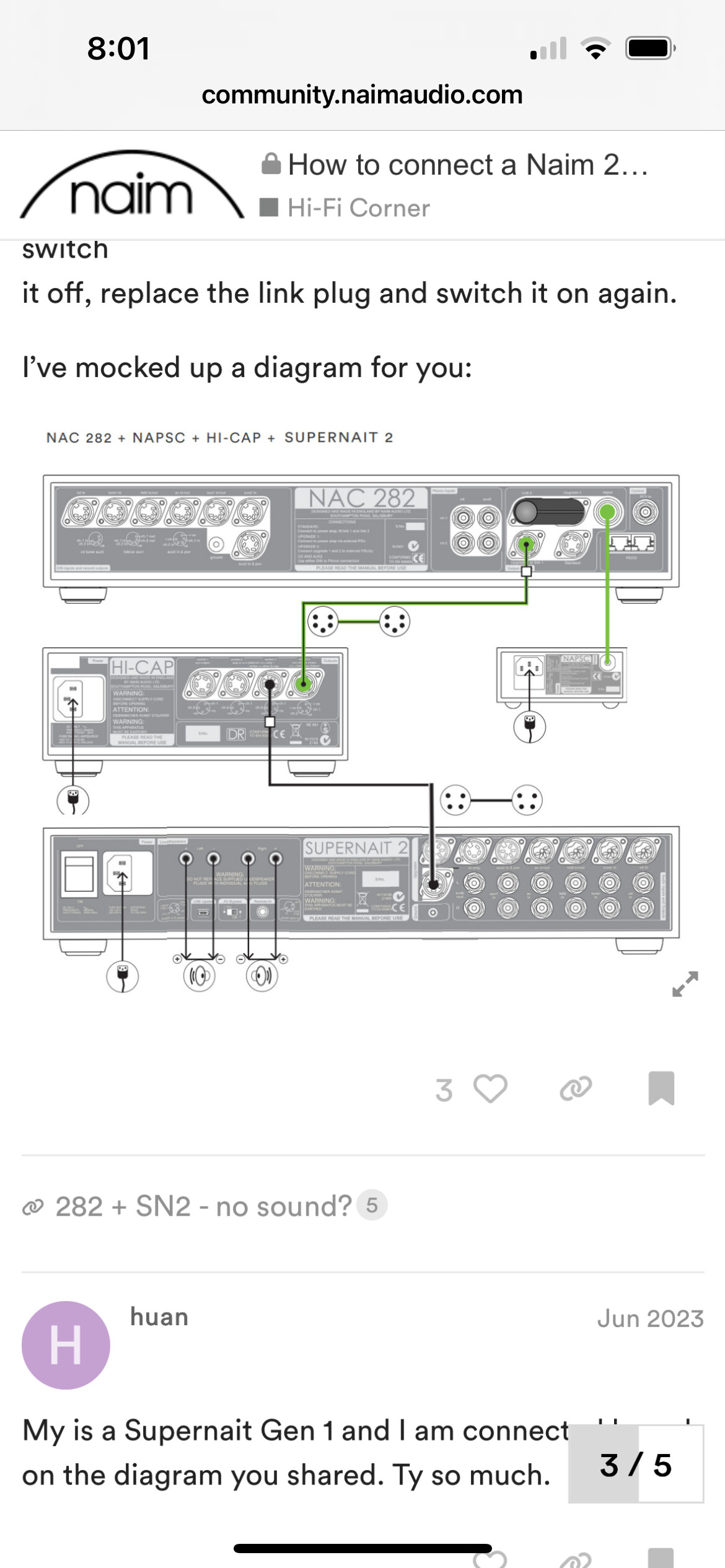

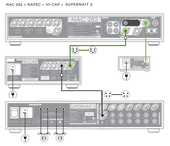

I have uploaded the diagram that show the same for SN2.. is it the way to go?

Hello all. So 282 is here. I configured XS2 as amp. Conntected the 282 via HC2. All as shown on diagram. NO SOUND..:fearful:
