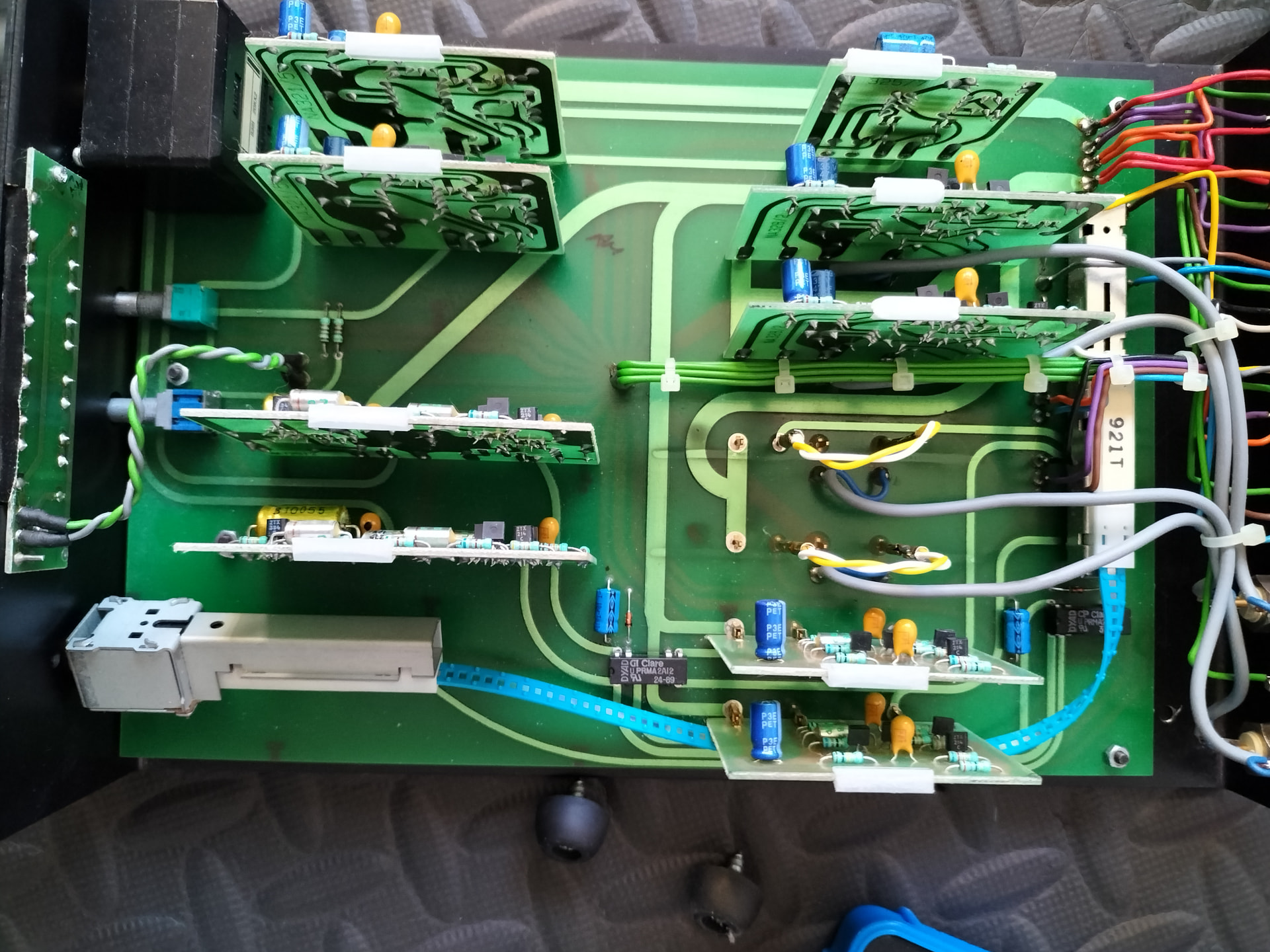

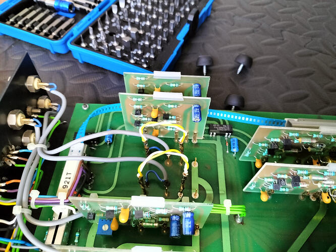

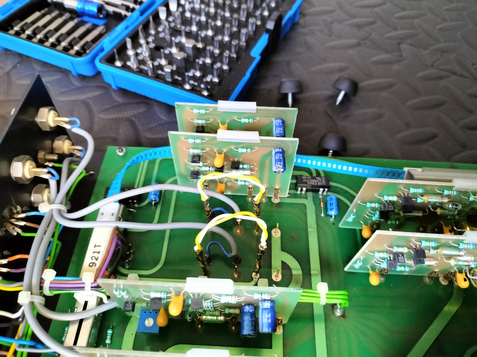

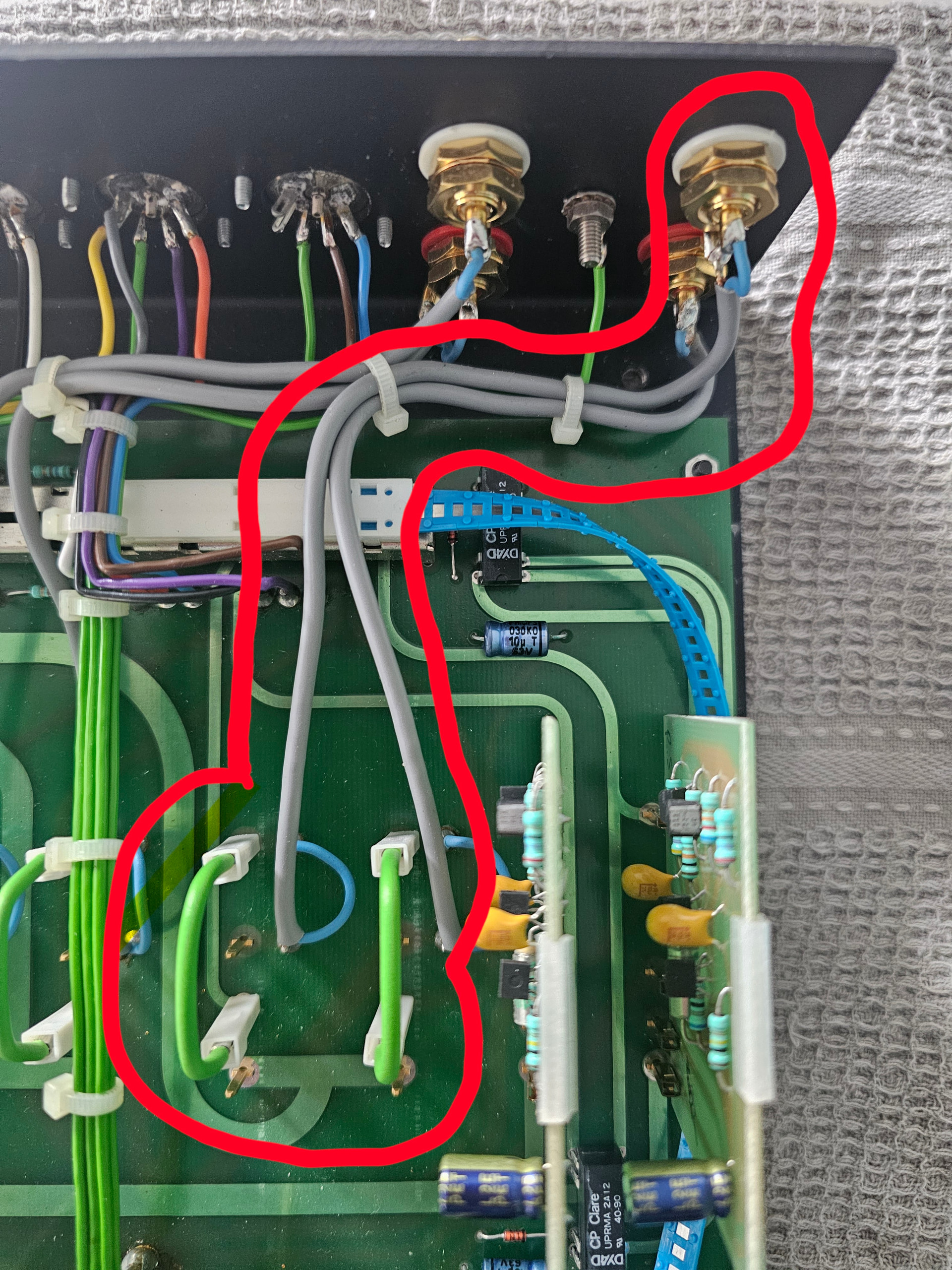

How can I change my phono input to a line input on the Naim nac72. I have tried to find the correct cards/boards, but to no avail. Will I be able to use the wire version of the line through cards. I did this to the cd input many years ago, but on the phono input it has a track off one of the connecting pins. I didn’t want to do any damage to the motherboard. I will be using a MM phono stage. Will the wires in place be ok for this purpose and are they on the correct pins. Thank you for your help.

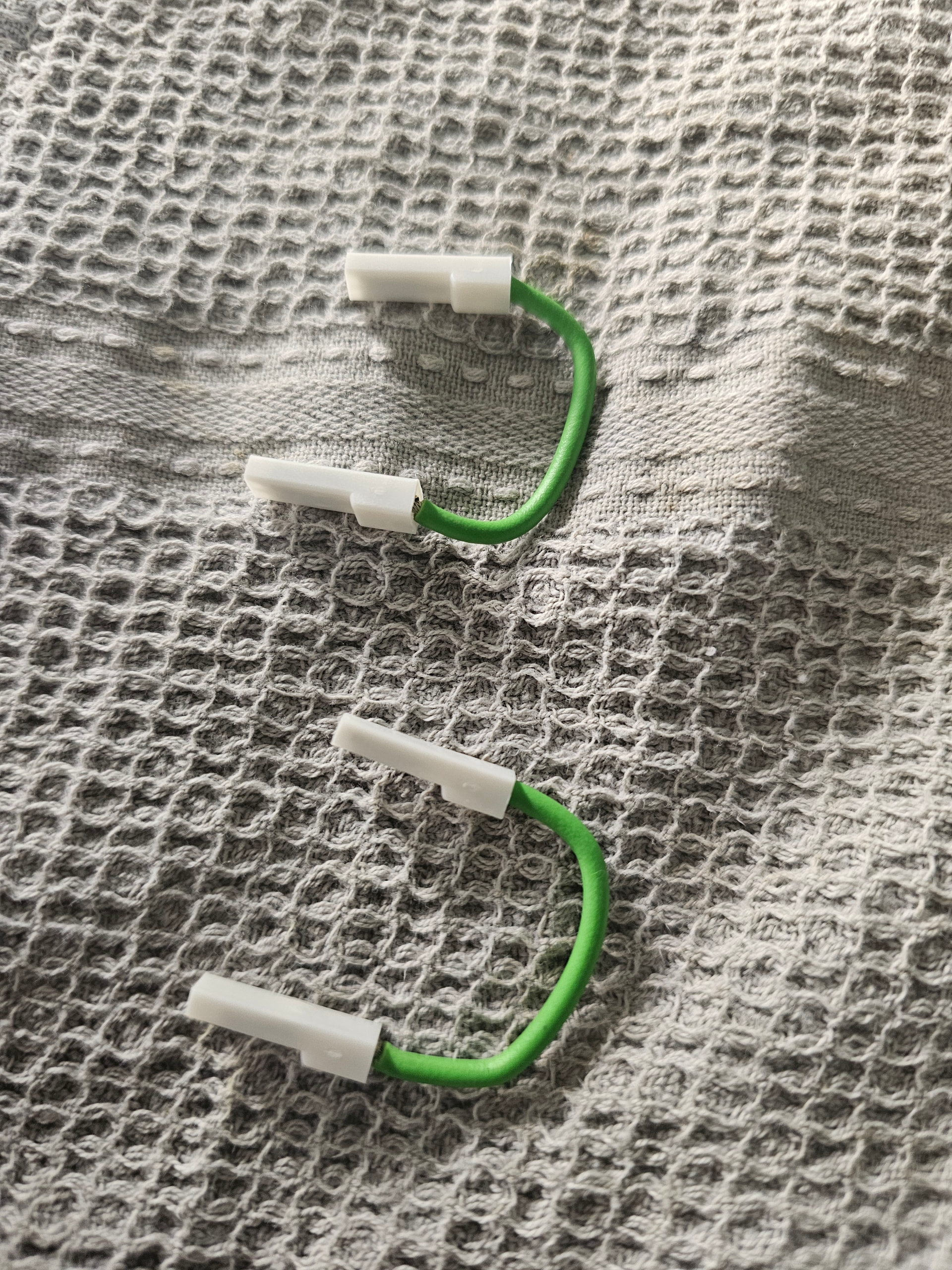

You may be better off making links such as these green ones. Allows easy removal if boards become available. But your connections to the pins look like those on my 72.
Thank you for your help, I truly appreciate it. I have them in the correct position, I am going to use the input for A MM Phono stage and a Project Turntable. Have a great day.
