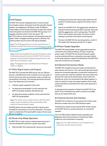

There are 2 other options for the xs3; av bypass or power amp mode. But if you are looking to permanently use the xs3 as a power amp it might not be the best option.
You are also correct that you won’t get the Naim sound if not using a Naim pre.

I dont think the NAD pre-amp will play well with a 250 power amp as the SN2 and 3 in AV Bypass using NAD in pre-amp mode sounded a lot worse than using fixed output into normal line level input of SNs.
