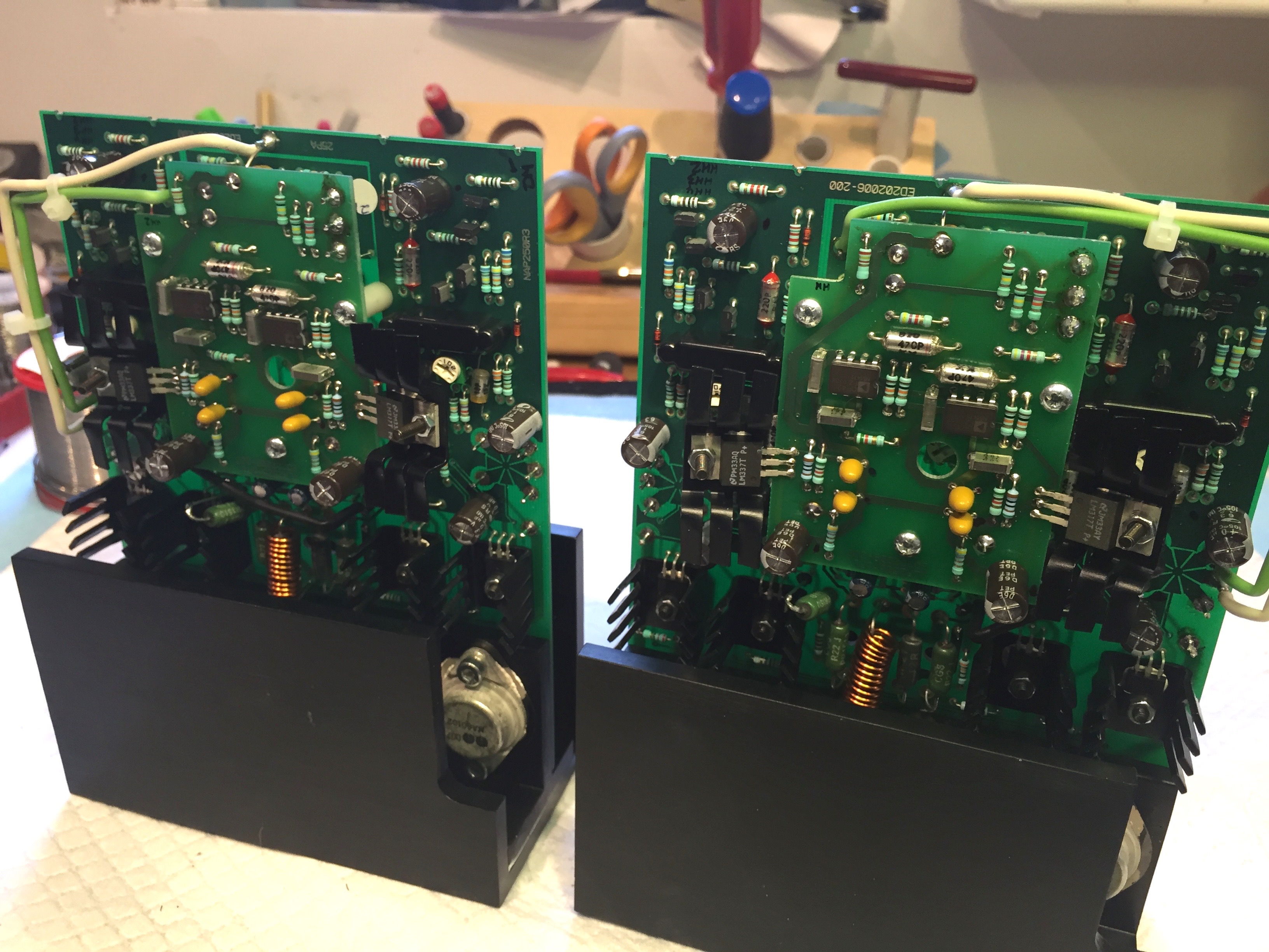

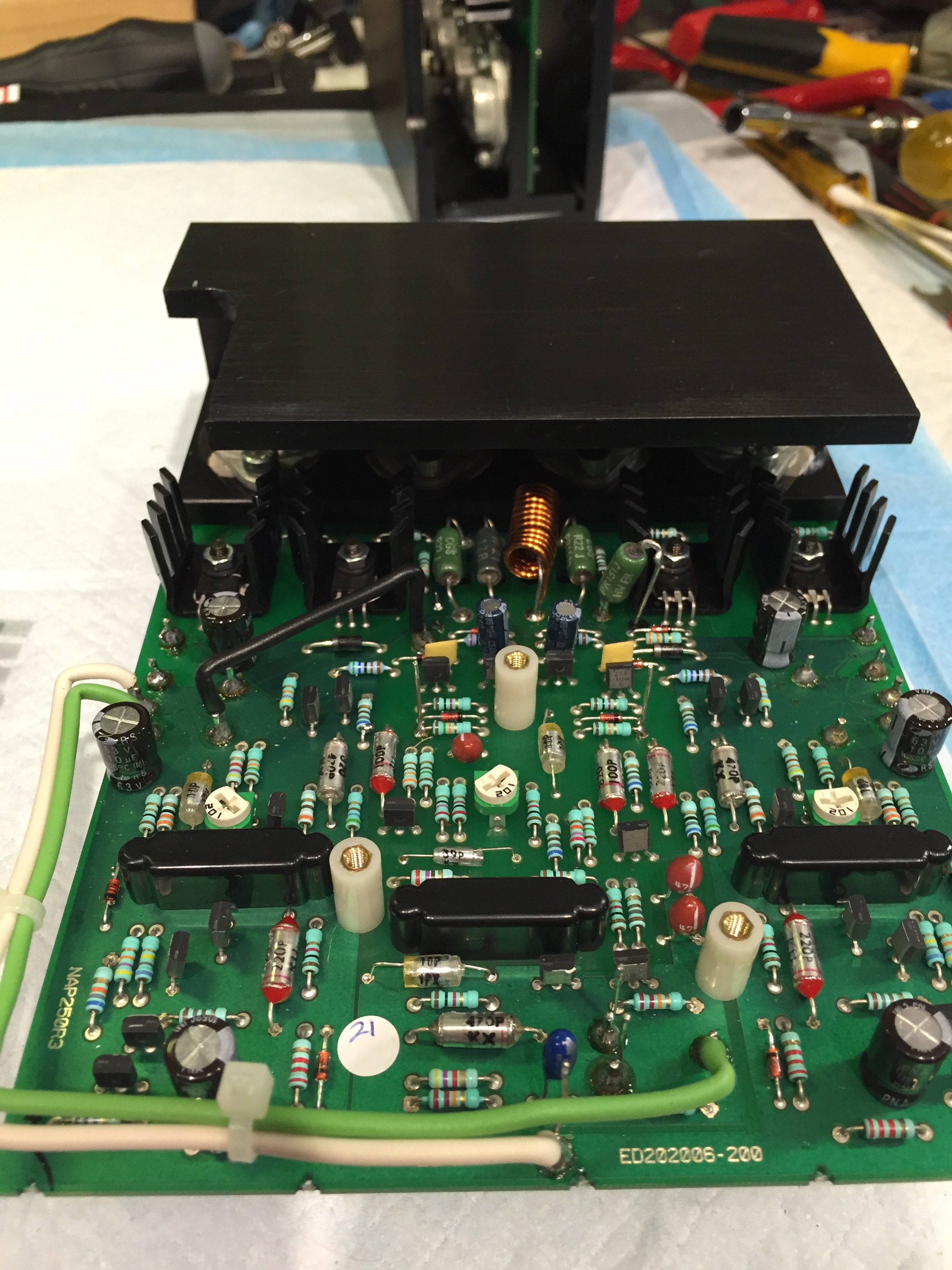

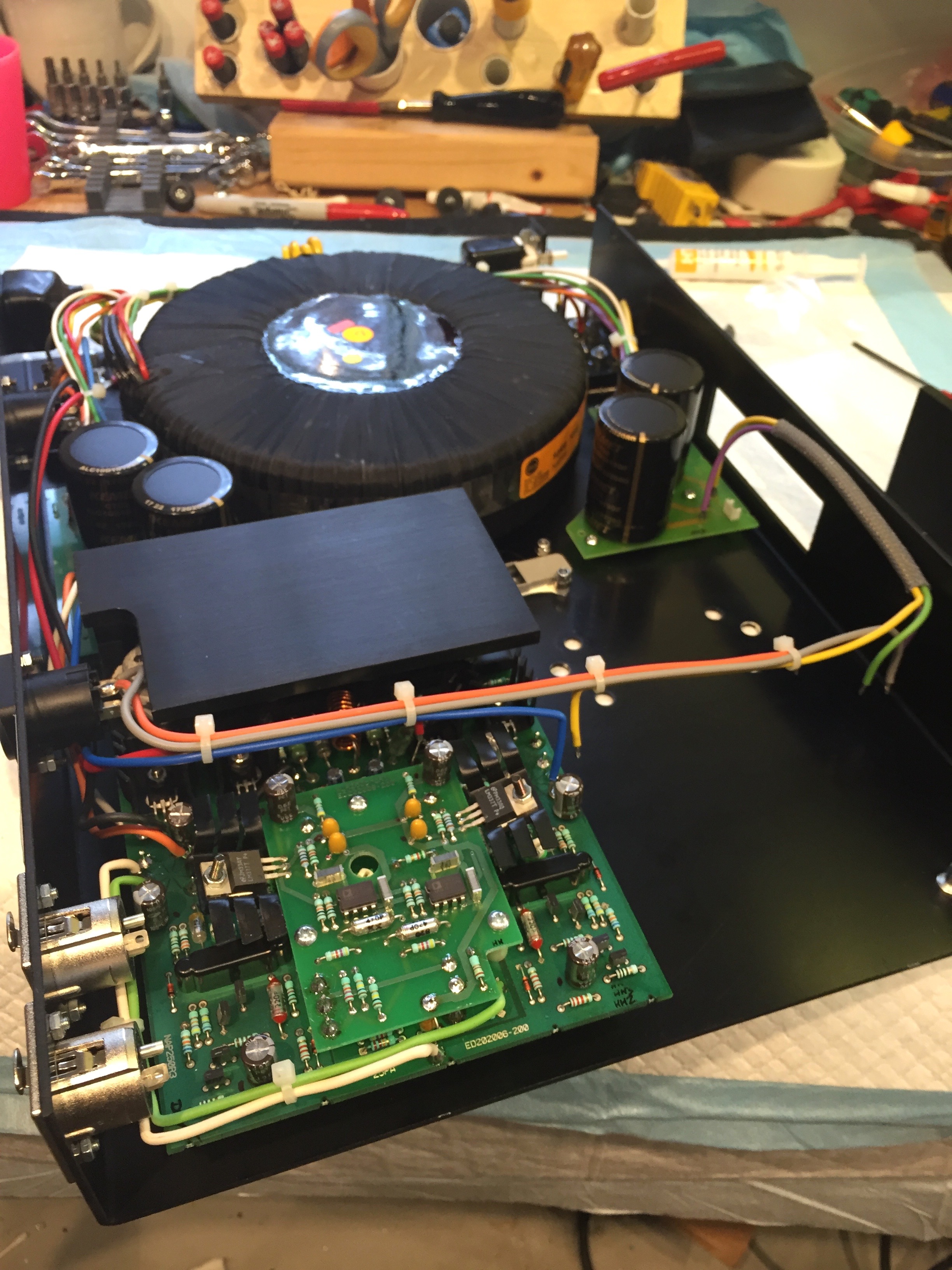

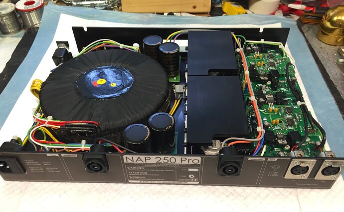

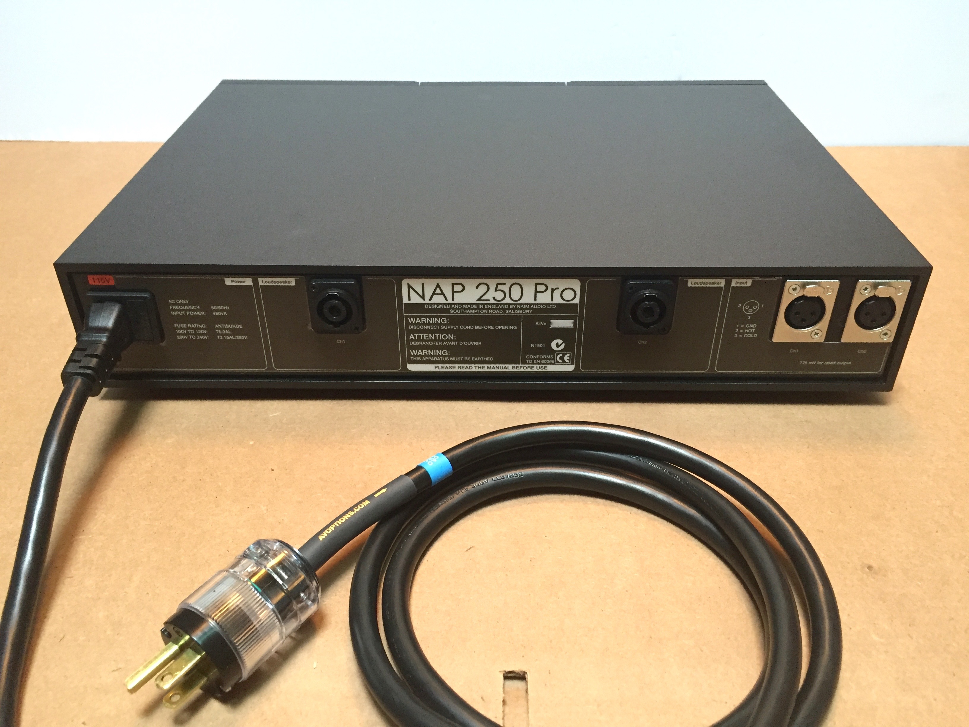

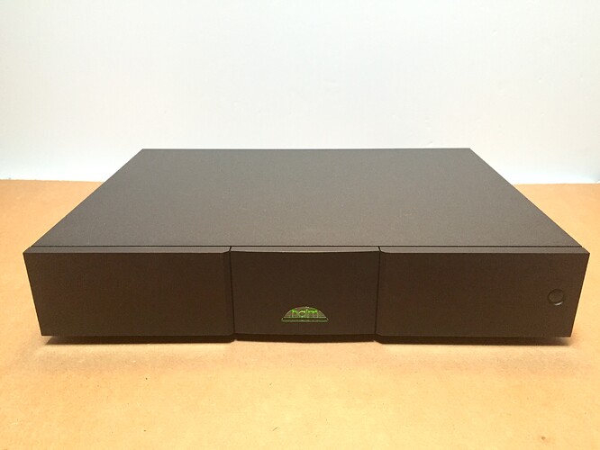

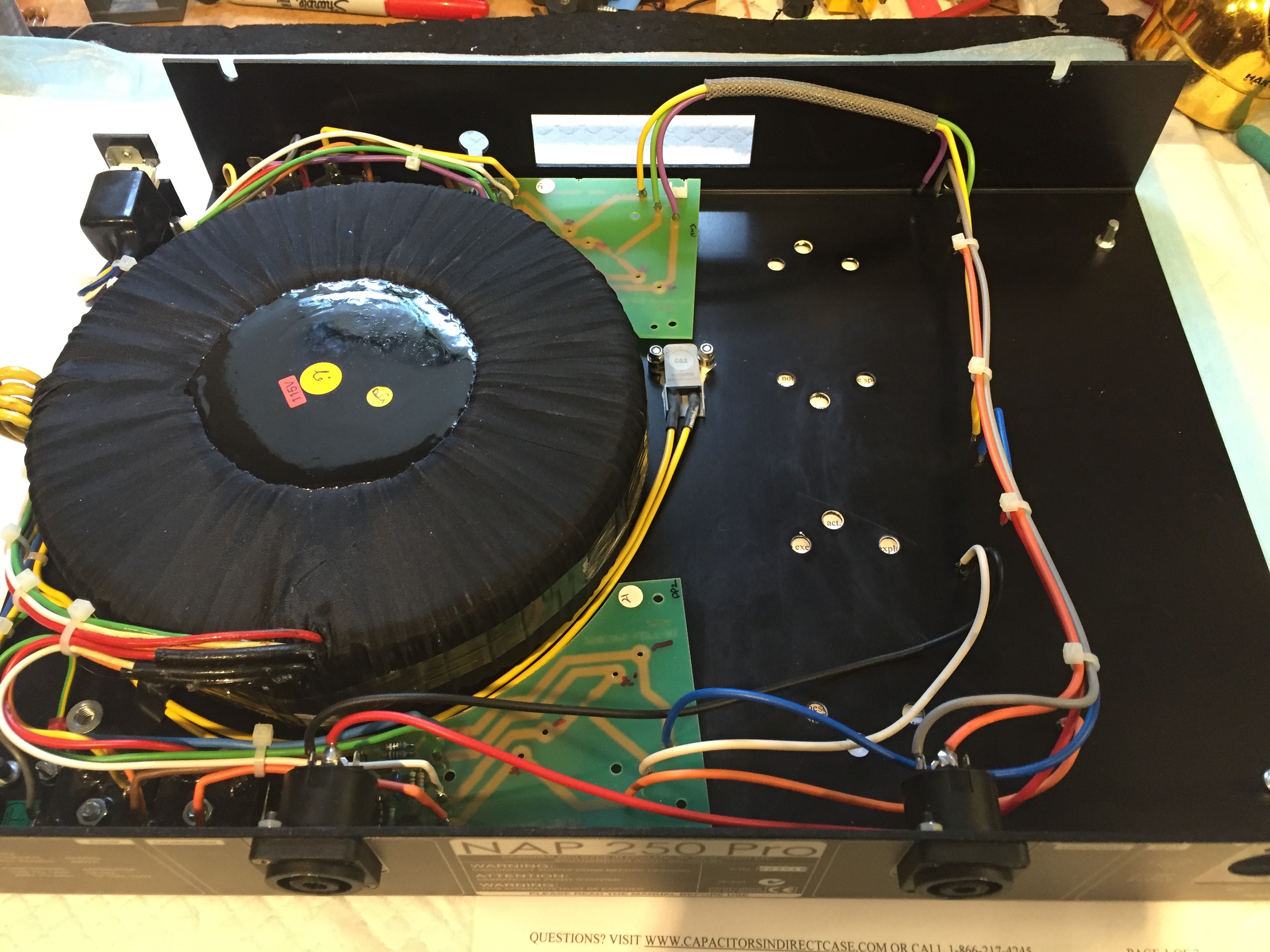

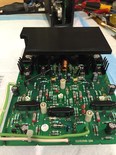

For the curious, this is a rare Naim product developed with collaboration between Naim and the BBC. It’s one of three delivered to the BBC. It’s based on a NAP 250-2 amp, and for studio purposes it has a balanced XLR input for each channel, and “Speak-On” output connectors instead of Banana sockets. Having recently restored one, here are some pics I took:
Amp boards removed and chassis cleaned
Two pairs of power supply reservoir caps removed
Amp Board ready for rebuild
Rebuilt Amp boards & balanced circuitry
Reassembly of Chassis
Completed Chassis
Front Panel
Rear panel (with new XLR and Speak-On sockets)

I spy with my little eye output inductors! Presumably the BBC wanted to be able use any standard speaker cable without restriction.
except it seems it be a US voltage version.
ChrisW
February 6, 2020, 12:04am
6
Yes it’s 120V … the owner moved to the US and had it converted
The amp had to be stable no matter what kind of speaker cabling was attached to it.

Which power cable is that ?
