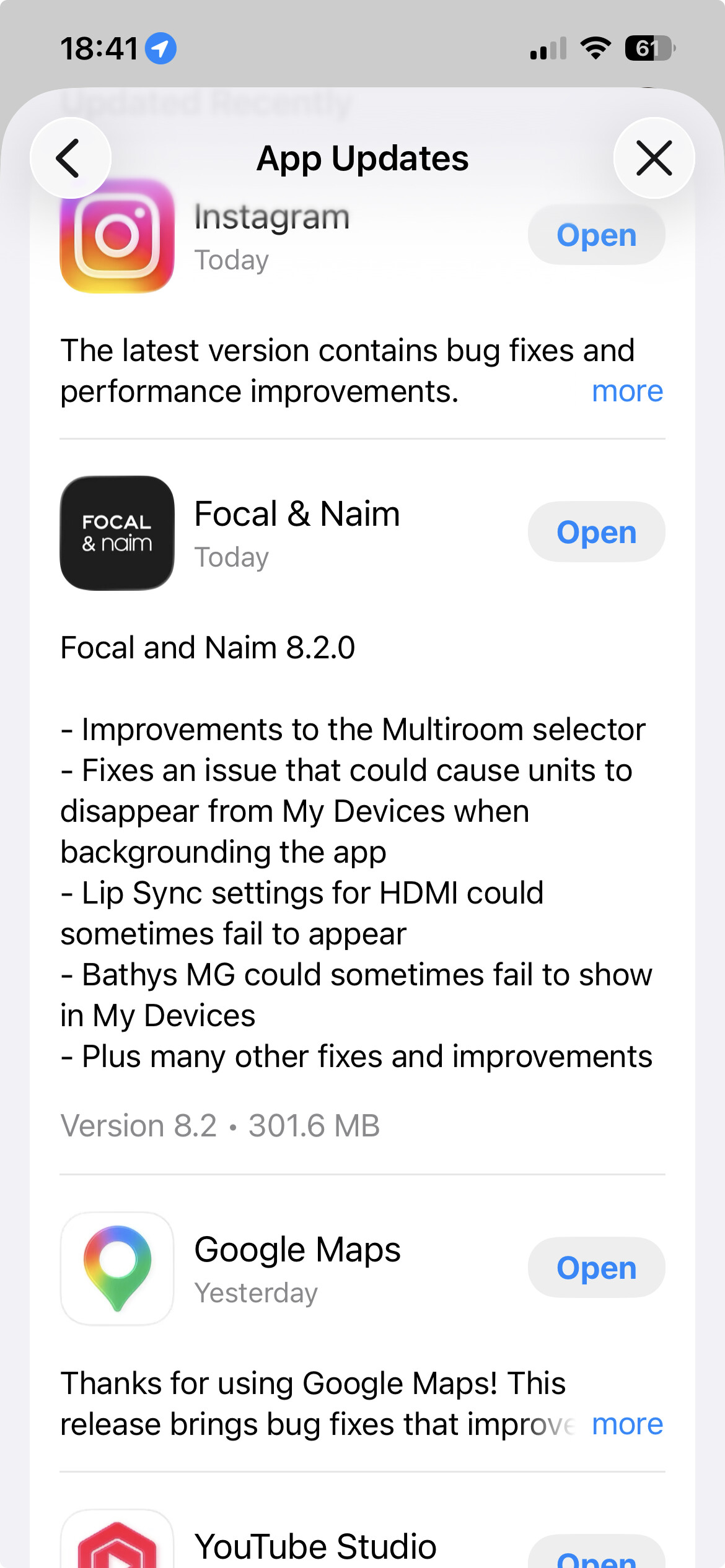

There’s a new version of the App just out that has a fix for devices disappearing. Might be worth a try.

According to the Apple App Store, there are no updates- I am running the current version as of Aug 3. Do you know when the app update you are talking about dropped?
Today. Version 8.2.0.

Thanks, I will check to confirm 8.2.0
I downloaded the 8.2.0 on both iPad and iPhone just now. No time today for listening, but I will give it a go the next few days. Boy, if this works that would be a great simple solution. Fingers crossed.

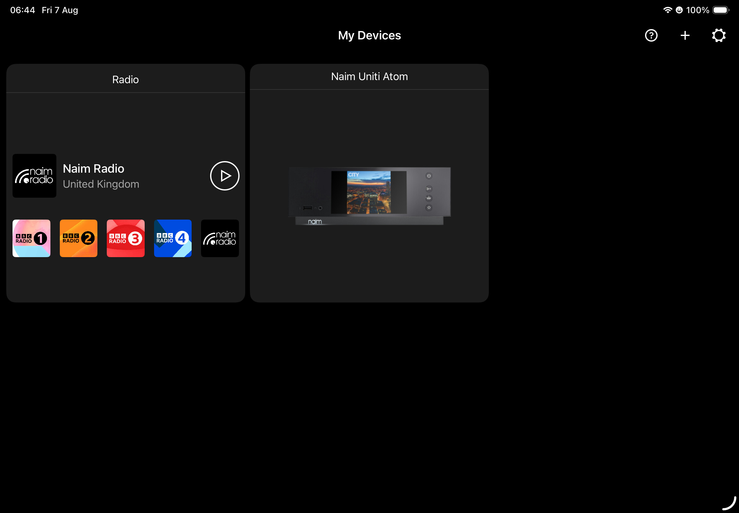

Ok, that’s definitely another data point albeit a little confusing!
So, just to make sure we’re on the same page, are you saying that the Atom appearing on the front page as above is unreliable? Or does the Atom always appear, but then once you are playing music from USB, it disappears and dumps you back to the screen above?
How do you play radio when it works? Do you go into the Atom and select radio, or do you use the radio section above and do something like Airplay it to the Atom?
Finally, what router do you have?

A- the Atom is almost always present on the screen as you have shown. Occasionally, it is not giving a “would you like to add a new device” error. Typically (but I can’t swear to it being 100%), I try my other iPad/iphone, which works.
