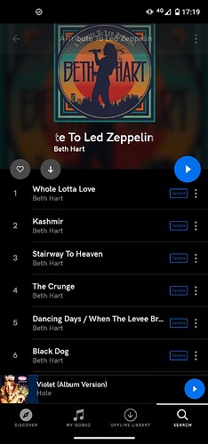

I don’t know about the Tidal version, but on Qobuz all of the tracks are marked as “sample” and if I try to play them in the Qobuz app it says “not available”, so something is odd about it:
