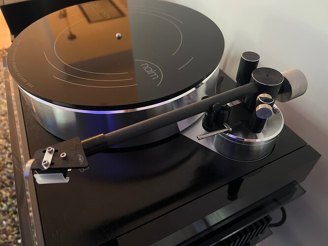

I’d like to ask members if they have successfully used a tonearm lift off device with the ARO? I mean things like the Little Fwend or Audio Technica 6006R that automatically lift the tonearm off the record at the end of the side. I am not lazy or overly concerned when using my other tonearms - SME V, Sorane SA 1.2 etc - but my ARO is on an SME 10 table which utilises a large screw down record clamp which is vital in keeping the record flat and parallel to the cartridge when playing. The ARO problem is that its head shell at the end of the record, if allowed to travel to the inside of the run off groove, hits this clamp and is pushed back. This can’t be good for the stylus assembly. Thanks

I wouldn’t want to replace the SME 10’s screw on clamp as I consider it vital to the performance of the deck. I use the ARO with an Avid Slide - an adaptor that allows the fitting of the ARO on tables that have the SME arm base fitting and allows the ARO to be moved during set up to correctly adjust overhang. The SME 10 as a skeletal table has a lovely open and airy sound and is a good match with the ARO sonically imho. The ARO- matic seems to be just an arm lift but as I can’t find any info on the web I am in the dark - but thanks for mentioning it.

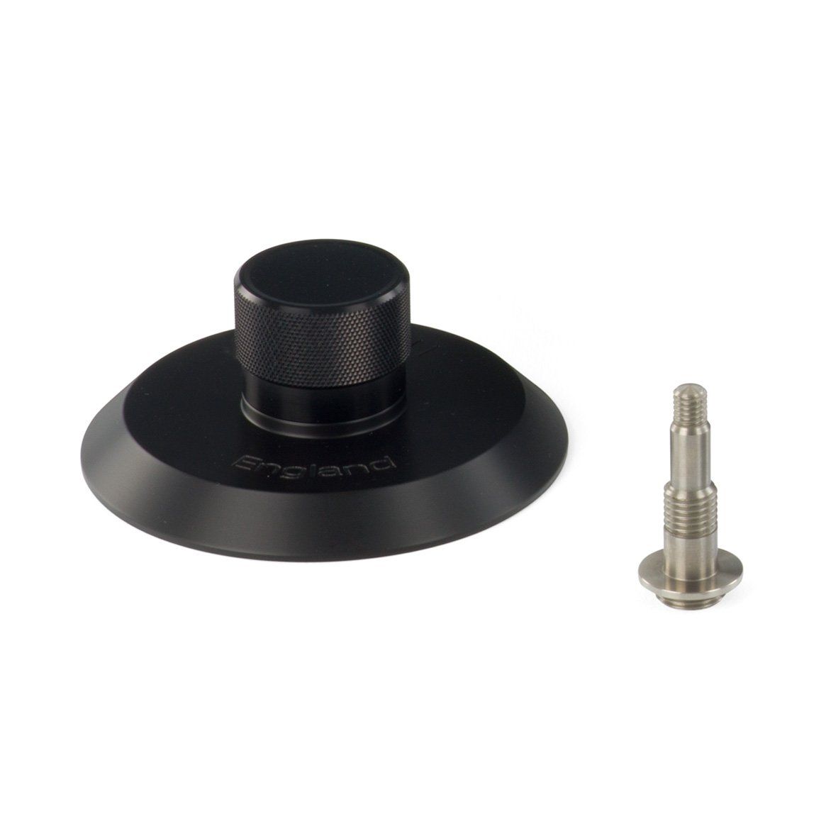

With another clamp that clears the Aro. Problem is, is there another clamp with the same thread system and the right diameter pressure ring. The SME looks like it has a male thread on the spindle, so does the Michell Orb but are the threads the same? As the Michell clamp would clear the Aro.
The central washer with a clamp dished on the underside that contacts at its outer rim is I think usual with dished platters, it’s how my Rock works. The SME one may have some damping too but if it’s interfering with the Aro there could be other options. try your autolift idea and see how you get on but if it doesn’t do the trick it’s possibly not the end. You could even have something custom made if all else fails.
This is the Michell clamp as presented for upgrading a Gyro.
Thanks for the info. I will look into the clamp if I have to give up with the auto lifting device.
