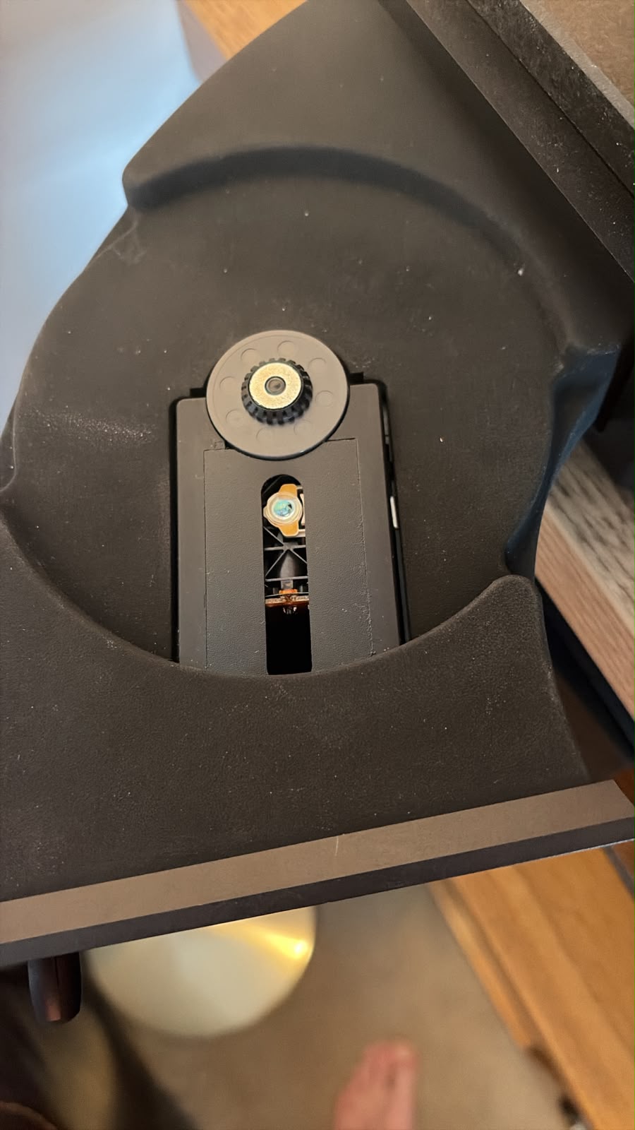

This is what the transport mech in the CD5xs should look like.
The mechanism I’m buying is from the same player as mine. It’s being delivered tomorrow so all I have to do is remove the platter from the donor mechanism and fit it to my player.

Good morning guys, I received the ‘donor’ parts yesterday and upon upon taking the substantial packing off, I found a whole thing intact which included the pull-out tray.
I managed to take the whole mechanism out to lubricate the sleds and do basic checks to see if anything was cracked or full of dust etc. I had a can of compressed air so I used that before commencing anything and apart from the accumulation of dust all looks good.
I carefully removed the platter from the donor mechanism and fitted it to my player, then plugged the player into the mains with the lid off, put a CD on and hey ho, it plays ! .
I left it playing for the duration of the CD [79mins], and the put the lid back on and connected it to my amplifier.
On first listen it sounded awful if I’m honest, so I left it on repeat until late last night, then had a quick listen, all seemed better but I was really tired at this point so I went to bed.
This morning I called my missus who’s off work today and asked her if she could have a listen, and she reported it sounds fantastic but the green logo is a bit dim which I didn’t notice myself. I’m assuming Naim could fix this ?
Anyhow, it looks like it’s a keeper and I may get a Flatcap for it soon but not sure which one yet.
