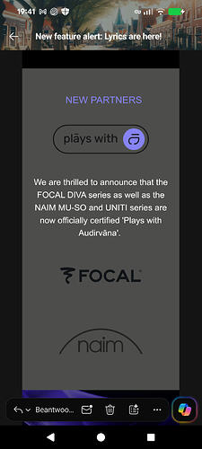

Got an email this afternoon from Audirvāna stating the following:
But I noticed to my surprise when starting Audirvāna this afternoon that the ND5 XS 2 was certified as well.
