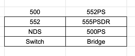

Some advices I had been given:
  • no ps under nd555
  • no ps (best nothing) under 552
  • 500ps and 552ps not directly above/beneath.
I’m planning on re-stacking my Fraim now when my LP12 is here. My main source is still digital so that’s why I’ve placed digital components in the left even though the 500PS under the LP12 might be destructive for the LP12 performance. Any other proposals that might work better?
Doing this also means that some cables will touch the floor. I don’t see any solution to 500 burndy not touching floor even though I’m placing the boxes diagonal. But it is more or less impossible to follow all Naim suggestions simultaneously..
Fraim today
Fraim after re-build
The ‘after’ picture is not dissimilar to my arrangement. This way at least, although they cross, the 552 and 500 Burndies shouldn’t touch the floor, nor should those from the CD555PSDR to the NDS - if they do, you could try putting the NDS up one level.
Putting an extra shelf on the right hand side would balance out the look.
That would give you the gap to the PS, plus future proof for another bit of kit if needed.

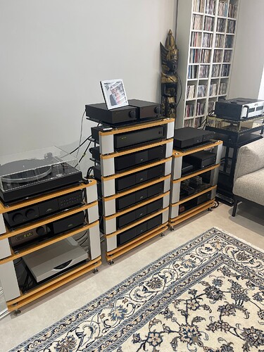

Arranging everything in a good way is crucial to good sound. If possible:
  • All power supplies should be fully separated
  • Power amps with transformers should be with power supplies
  • CD players should be separate
  • Head units should be separate and to the left of power supplies
  • No interconnect, SNAICs should touch anything else or the floor (i.e they should float)
This is not always possible, but sometimes you can (I needed a lot of space). In my case an active system so even more cables (Geek mode on) (Stand geek mode - spot the gold Mana)
