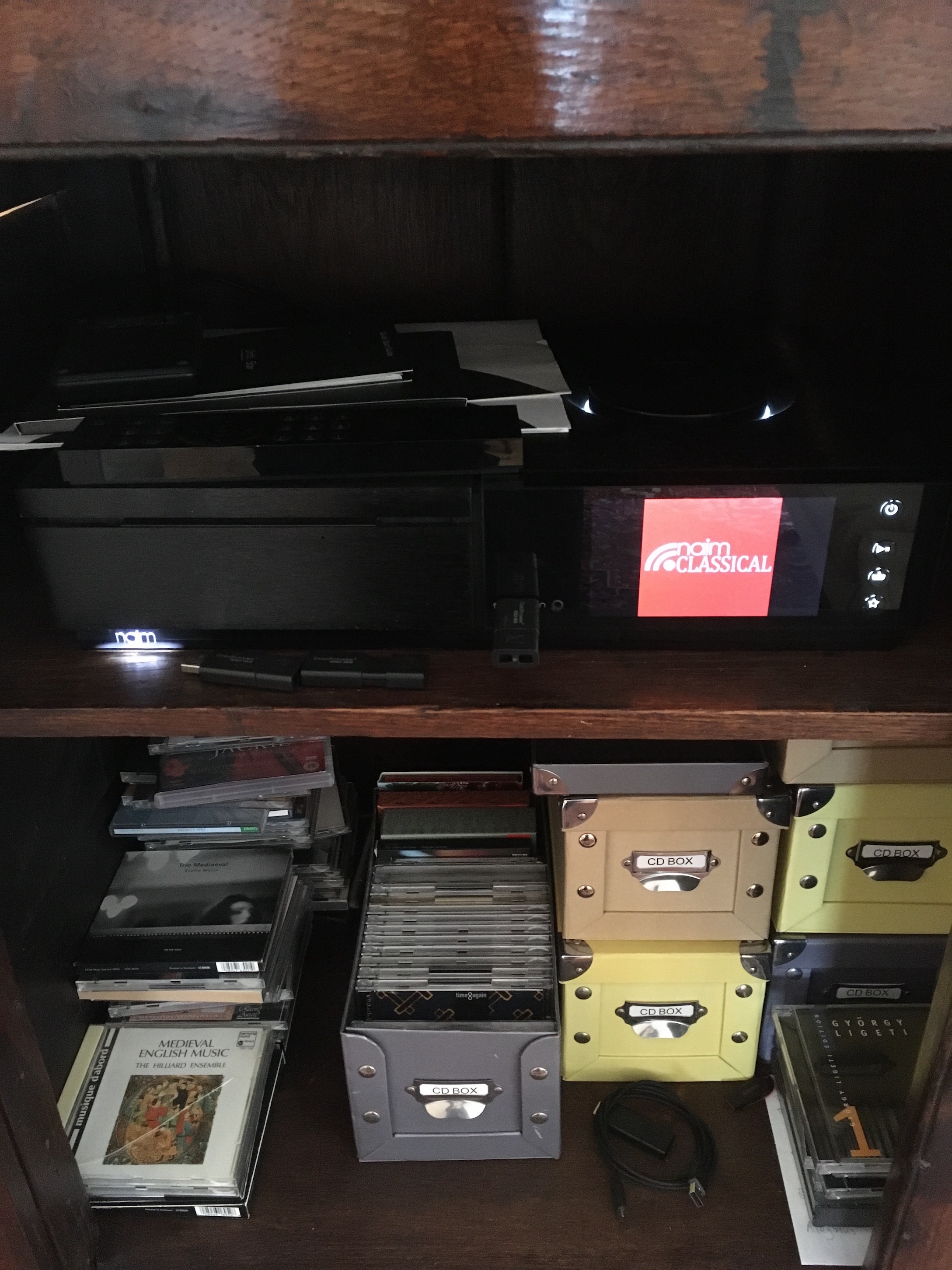

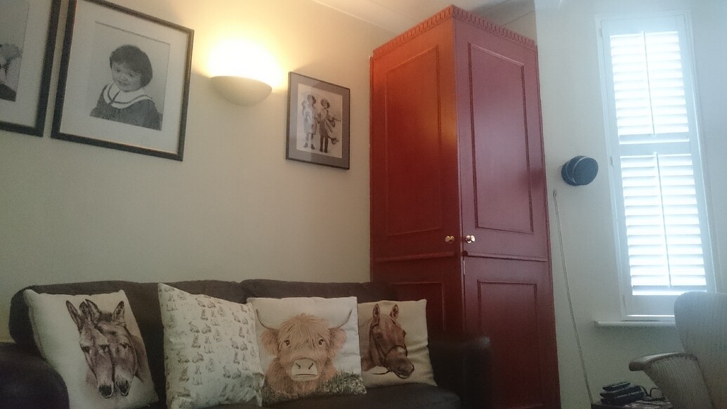

Maaaaany moons ago I had the front room set up with what my wife lovingly calls the ‘Shower Unit’:
This is two doors designed so I can completely open them up, as there has always been talk that placing units in a cupboard is deleterious to sound quality, in the event I didn’t find this.
In the cupboard I use a standard HiFi floor unit, a wall unit and a turntable shelf.
The ventilation can come from leaving carpet off the floorboards, but this lost too much heat in the winter so during the hottest summer days I run a couple of fans from the USB ports on my Oppo to cool my 300dr.

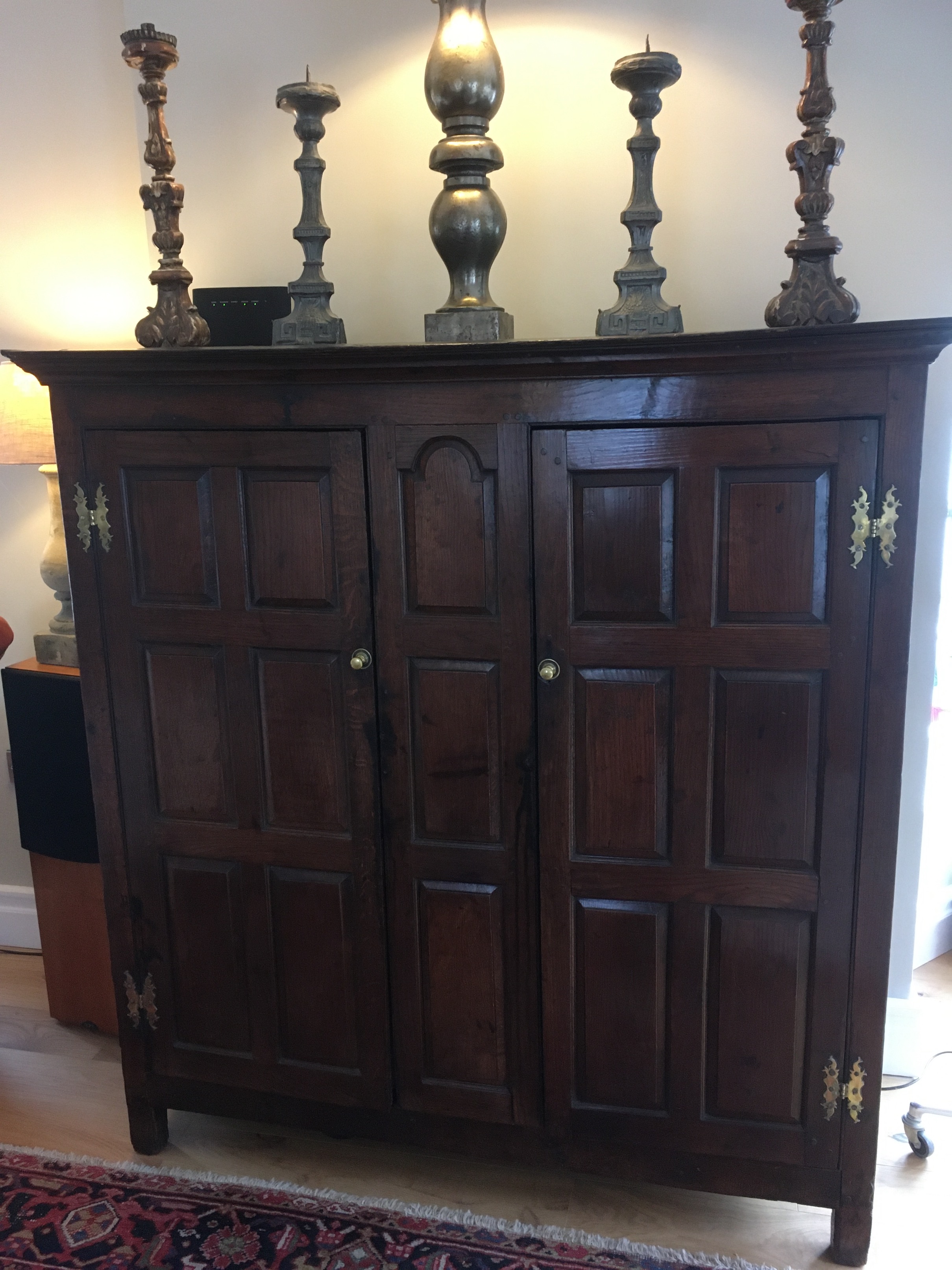

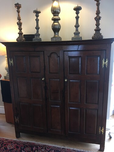

I’m running my Naim setup consisting of a NDX5 XS streamer, NAC82 pre-amp, NAP250 power supply, HiCap, CD3.5 CDX with the whole lot housed in a (supposedly) antique Chinese cabinet (yes, a senior management decision).
The back of the cabinet has had a series of large vents made to provide airflow.
Nevertheless, the NDX5 XS doesn’t seem to like the heat generated at times and so I leave that switched off when not in use (it’s a pc on steroids afterall) and ensure that the cabinet doors are left ajar at all times and fully open when playing.
After nearly 10 years the original Naim gear is unaffected by being housed in a cabinet and sounds great working into my ProAc Response 2.5s. The NDX5 XS streamer’s sound and it’s overall performance seems to my ears to be unaffected by being switched off when not in use and then back on for each listening session.
