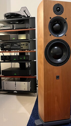

Hello everyone. Once again relying on the communities vast knowledge base.
I recently got a pair of ATC SCM40 passives. I used it with my NAC 252 pre amp, NDX2 and NAP 300DR. Now on this setup turning the 252 volume to around 9 - 10 o clock is about as loud as I can bear without getting knocks on my front (and only) door. Normally I listen to about 8-9 position.
I also got the ATC P2 300 Watt power amp. When this is connected to the NAC 252 I need to turn the volume to almost 11 (even 12) to get the same perceived volume level. Why is this and why did I expect the P2 to sound louder (at the same volume setting) than the NAP 300?
Why 90W sounds louder than 300w at the same setting? Or at least that is what it sounds like to me.
