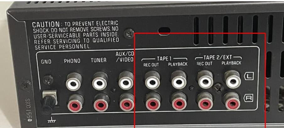

Ah, ok, so a DIN Headline. In which case you probably have the wrong interconnect/adaptor. You’ll need a custom one so the rec out pins of the din are connected as the Din is designed to connect to a tape in/out din on a preamp. See the faq on connecting headphone amps.

My 5 Din Male Naim Connector was connected to a 5 Din Female to 2 Pin RCA Male Connector which was connected to Audio Output RCA Jacks on each device. Am I reading that I needed to buy the 4 Pin RCA Male Connector even if I only used 2 of the 4 pins? Also, is it possible that my DACs aren’t “powerful” enough and that I need to attach the NAIM to a headphone amp or pre-amp?
A regular off the shelf adaptor won’t work here as the DIN on the Headline is wired to take the signal out from the REC OUT pins of a tape in/out socket. Any adaptor would need to be custom wired accordingly.

If connecting a headphone amp to the integrated amp then yes, you would take signal from the tape REC OUT sockets. However, unless your adaptor is wired correctly (any off the shelf adaptor will be wired for PLAY, not REC OUT pins) then it won’t work. Your best bet here is to either make an appropriate adaptor with the correct pin connections at the DIN end, or have the DIN plug on the NAHA replaced with a pair of RCA Phonos. Your dealer should be able to do this for you.
