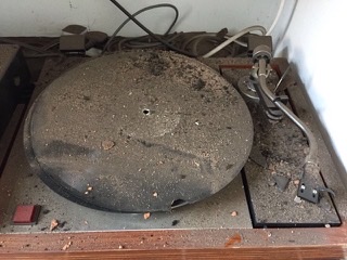

Hi Steviebee, up until last year it was 100% original. Unfortunately a brick fell down my chimney and well…image
Lesson learnt, hifi should not be kept in old fireplaces. Fortunately there was a local Linn dealer who restored it, the plinth et al was saved but a rega tonearm was used as the only one available at the time was more than the turntable was worth
Oh my goodness… what a sad sight.

Yikes! :scream:

Ouch! That looks heart breaking!

Pleased to say, it’s now back up and running…
