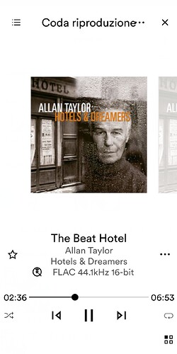

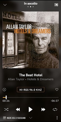

but opening the Naim app and entering the Qobuz input to play unfortunately the resolution is 44.1khz although the track is Hi-Res in this case while on the Qobuz app in Chromecast it goes to 96khz. and for the 192khz songs… nothing… what an embarrassing situation I don’t understand.

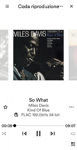

Hi guys, I think I get it. In the Qobuz app, although it is written Hi-Res, playback actually goes to 24bit and 44.1 kHz even if it is written down to 96khz. It therefore depends on the recordings even if they are Hi-res. On the Naim app scrolling through the tracks in my playlist I found 16bit/44.1khz tracks up to 24bit/192khz tracks as attached so I am not restricted to 96khz. I’d say the Naim app is better at this point. thanks and sorry
