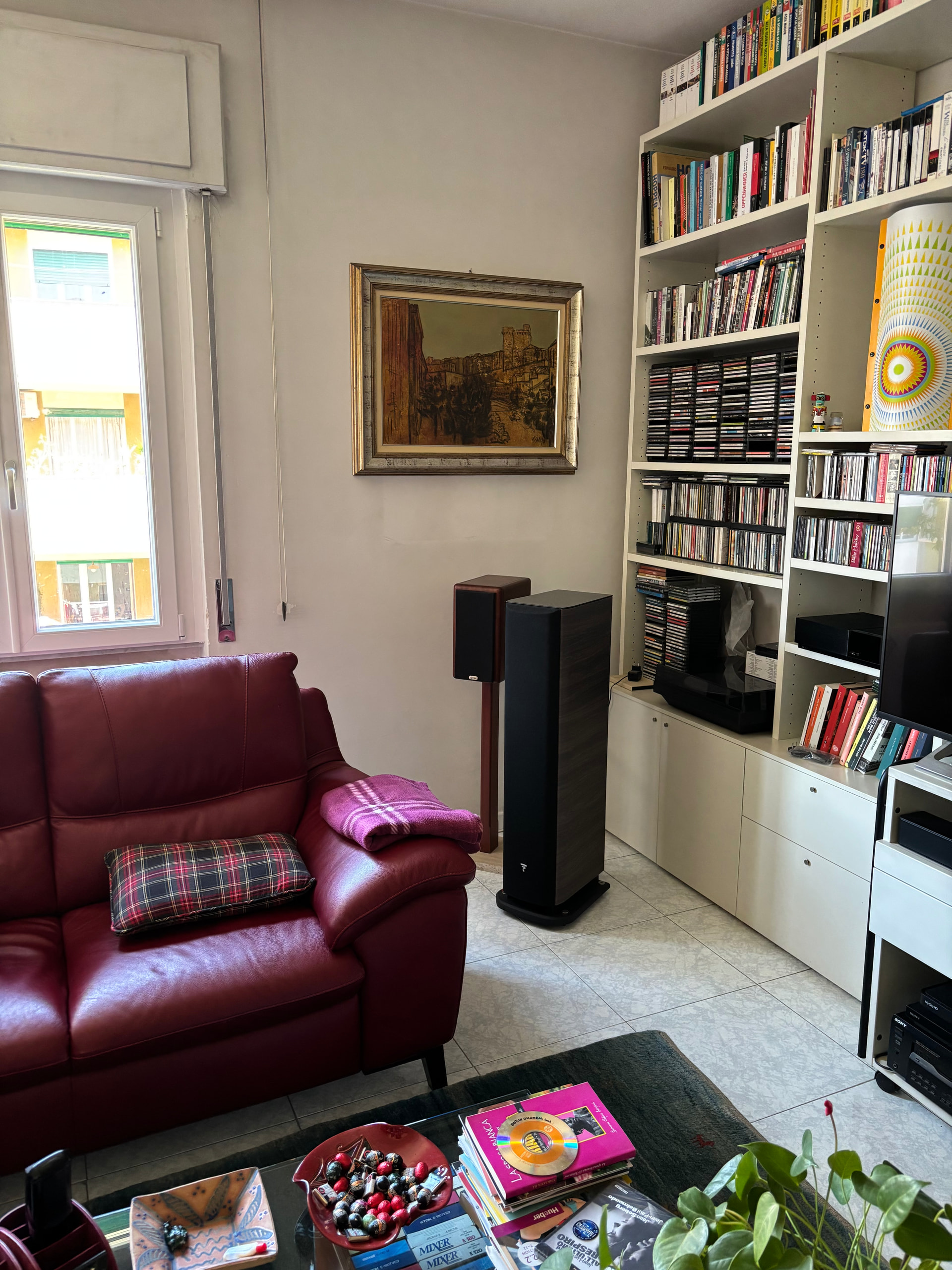

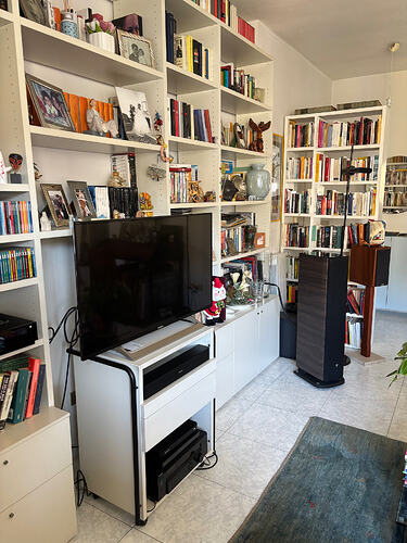

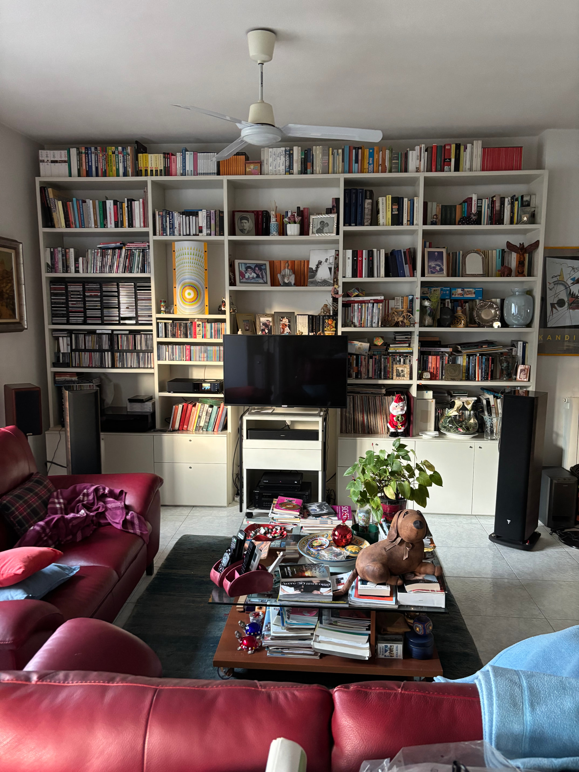

Recently I traded in my Naim Uniti Star for a Naim Uniti Nova, while keeping my Focal Aria 926 speakers. I immediately heard differences. Of course, the system probably still needs some time to fully settle in and loosen up, but it has also made me wonder whether my current speakers are not really the ideal match — and whether their placement needs more work.
At the moment, vocals, especially female voices, seem slightly recessed, while the bass sounds somewhat confused and not very well defined. After moving the Arias further away from the rear wall, the situation improved, so I clearly need to keep experimenting. Looking at the attached photos, which show the current setup, I suspect I may need to bring them forward a few more centimetres. It is also quite possible that the small table in front of the TV is causing some disturbance to the sound.
This, however, creates more difficulty for walking through the room (and my wife is not very happy about that…).
Considering the room where I listen and the furniture constraints, I’ve started thinking about the possibility of selling the Arias and buying speakers that might suit both the room and the Nova better.
The room is about 35 sqm. I would like to keep the speakers positioned roughly as the Focals are in the photo, with a listening distance of around 3 metres from the TV.

Have you tried the speakers with no or very little toe-in ?
I used to have the speakers set up like your photos and was surprised how they improved many aspects of the sound stage and presentation with the almost no toe-in.
Let the Nova settle in for a couple of weeks (ideally a month), and then reevaluate the sound. Keep experimenting with speaker placement to get the best from what you have. When trying new speakers, the old advice is the best - do it in your home with your Nova.

Following your advice, I’ve already tried adjusting the speaker placement. I moved the Focal speakers further away from the rear wall and slightly closer to the listening position. I’m also now keeping them parallel, whereas before they were toed-in and more focused directly on the listening spot.
As expected, the bass has improved—tighter and better controlled—and the soundstage depth is also better. Female vocals, however, still seem a bit “recessed” or slightly hidden. I’ll give it some time and see whether the overall presentation continues to evolve with further listening.
For the moment, I’ll keep them in this new position and spend some time listening to see how things settle. Interestingly, my wife hasn’t made any complaints so far, so they can stay as they are for now—the WAF hasn’t kicked in yet… though I wouldn’t rule it out in the future.
