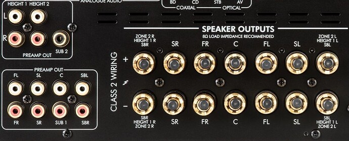

The AVR850 doesn’t have amplification for height channels, something like the matching class G P429 is suggested but I had one and it failed. I will be ‘outsourcing’ the amplification of the height channels and now the front LH & RH channel.
For reference the The AV860 is essentially the AVR850 minus the internal power amplifiers, but with the addition of a high-quality XLR analogue output. I am wondering about running an AVR860 with last generation naim power amps plus a naim integrated amp and streamer rather than a mix & match of amplification across the 7 speakers. Hopefully that explains the duplicated mention of AV Receivers/Processors in my original post.

I think if you check the manual, you will
I think if you check the manual, you will see that each of the AVR range can power height speakers - assuming you only want two. I think it has processing for more but has amplification for two. I hope I’m right as that is what I am planning on using!
Yes, sorry, I just checked the rear panel and you are completely right; I’ve been using those channels to ‘bi-amp’ my front speakers then earmarked them for SBL/SBR duties driving some little B&W M1s and got the P429 amp to run off the preamp out for height 1 & 2, (and two subwoofers at one point). I was also thinking of using them for zone 2 in the kitchen, forgot they were configurable for height 1 & 2, thanks for reminding me to check the back panel!
This has been quite useful as a bit of a sanity check, thanks to all that replied. I’ll go with the AVR850 running the height, surround speakers and centre then almost certainly a pre-owned SN3 or new XS 3 (both circa £2K) plus ND5 XS then keep an eye out for a NAP V145. Rather than wire in a zone 2 in the kitchen off the AVR850 I think I’ll pick up a Mu-so Qb.
