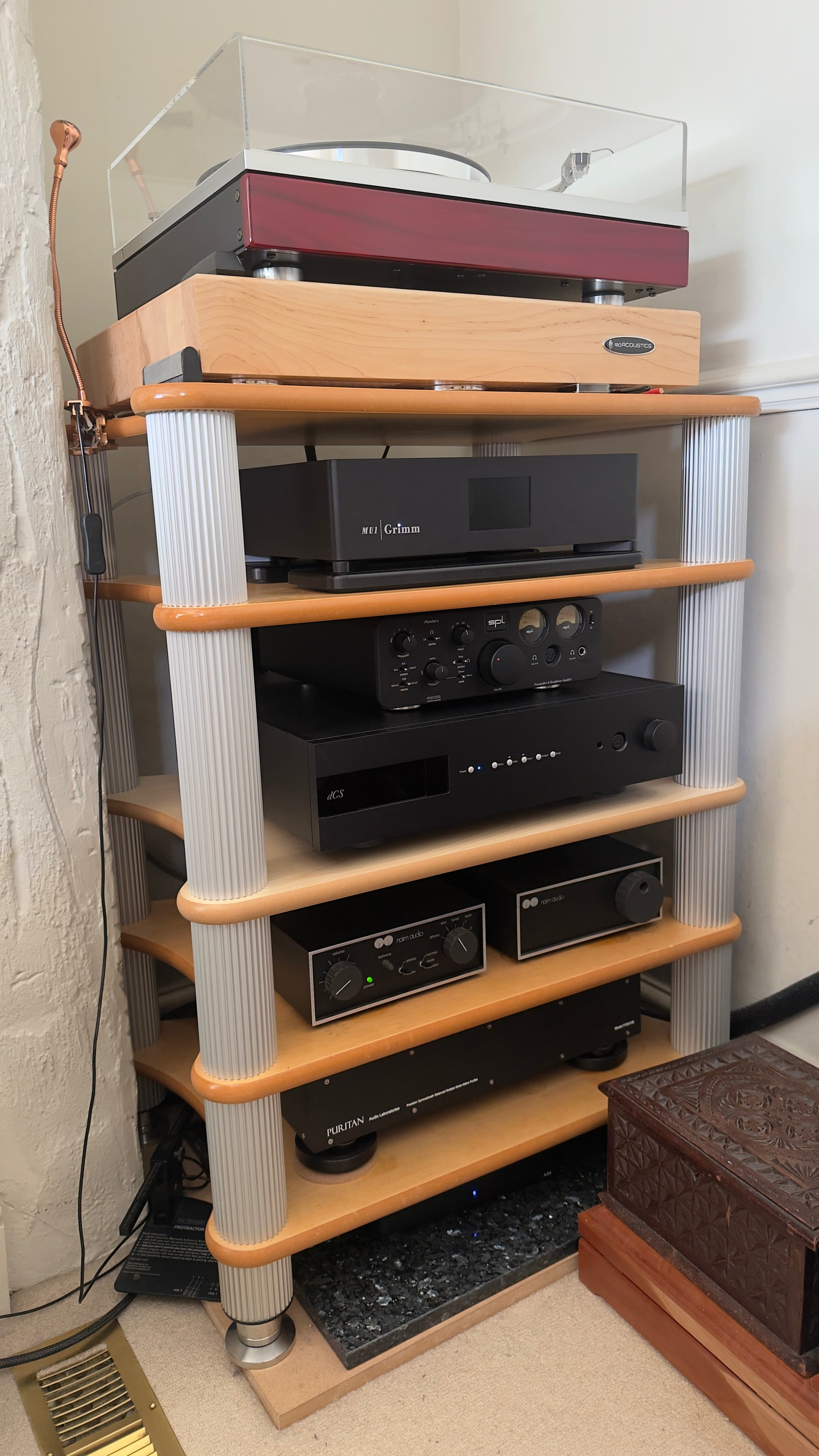

All up and running, i forgot how good sounding the 32.5 is. Very happy, i just need to get another 4 pin din to rca to connect to the headphone amp.
