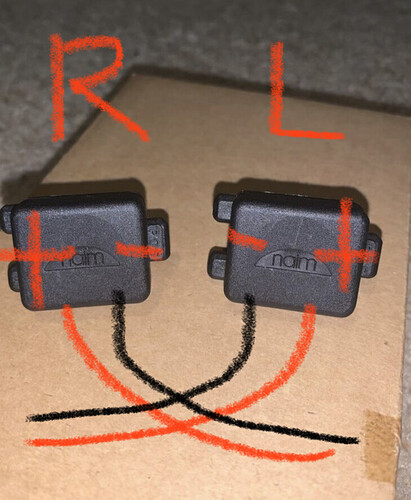

Looking at the back of the amp, you should have this:
If I’ve understood you correctly this has caused the speakers to be wired out of phase. Would it not be easier to reverse the connection on one of the speakers to correct it? That’s assuming you’re not using Naim plugs at the speaker ends?

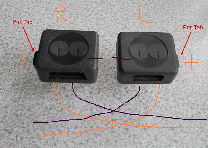

In this have you the pos on the base plate reversed on the teminals on the plug on the left hand side plug in the picture?
Surely you could push the pins out of the base plate, rotate by 180 deg, reinsert the soldered pins, and keep the plug tops as in your picture, but then by inspection the pos (positive side of the cable) will be in the right orientaton for the amp, and match the cable and pos tab on the plug base.
That’s a found image with my red and black finger painting added, just to show how the amp terminals are arranged.
OK…no worries, I was not having a go, I just like to see things right…
