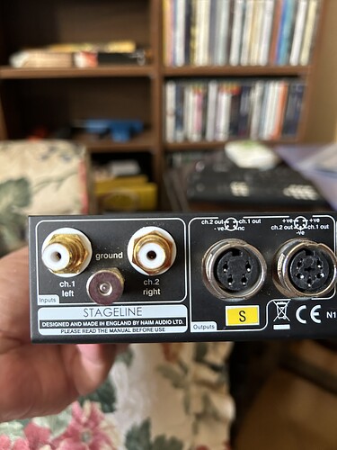

Hello, I received the stageline s that I bought, does it have golden rca connecters, do you think they are yours or have they been replaced? Thank you

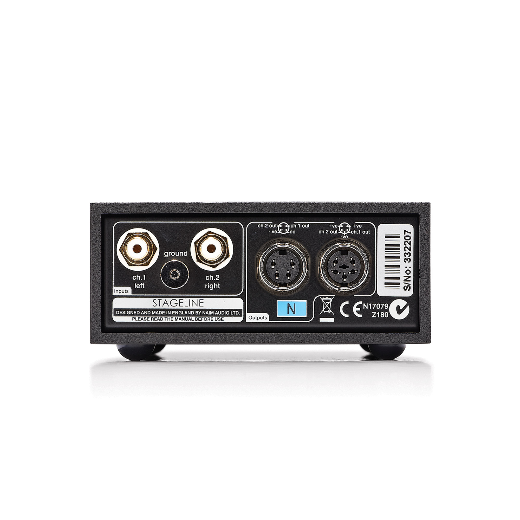

from the picture they look right. Here’s the official picture of the back of the Stageline (N version in this instance) from Naim’s website;
These are correct for the Stageline. The older models were different however.
That’s how my S looks.
And mine… :+1:
