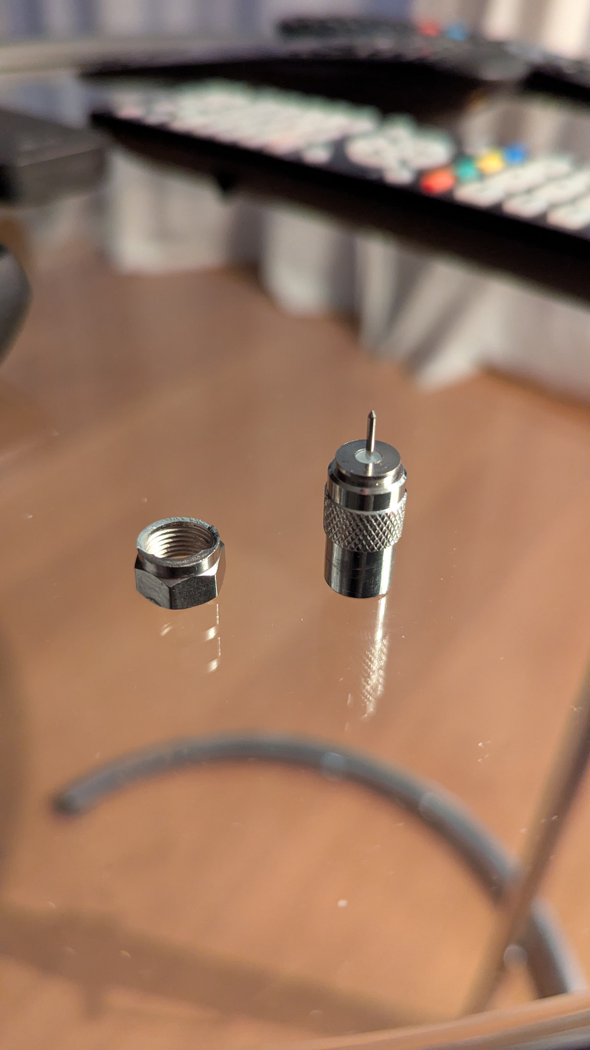

As I moved my Superuniti to add a new optical cable for the television, the radio cable did fall off. Trying to reconnect (even there is not signal for radio at the apartment complex anymore :wink:), I found these two pieces. Is this a broken adapter to connect a normal antenna cable to a thinner input, or what is it ?

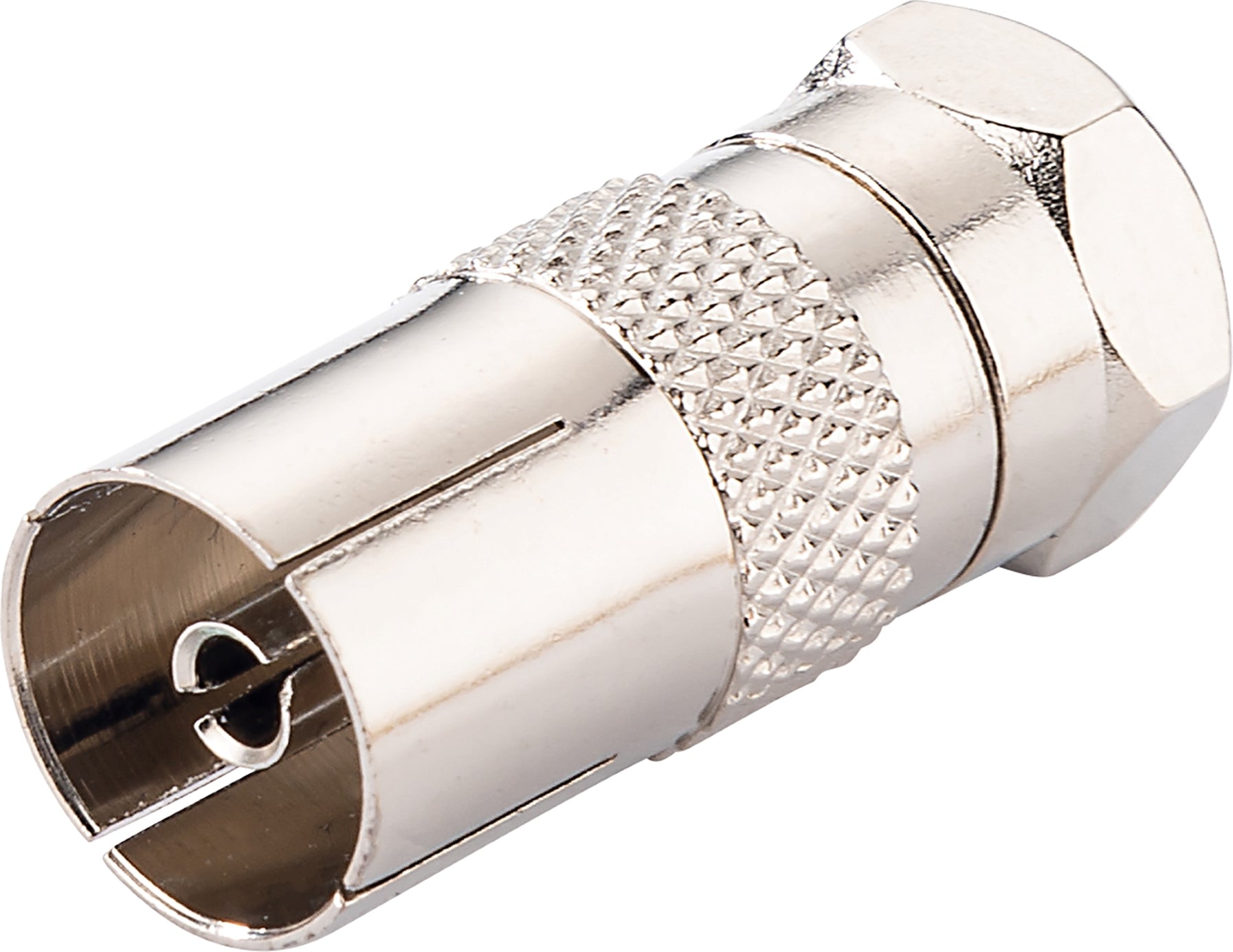

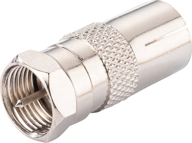

That looks a bit like the F type connector aerial plug, or possibly an f connector to Belling Lee adaptor that allows you to connect a belling Lee aerial connector to the Superuniti.
Thx Richard. Yes, found it. And the one I have is broken in the middle, but only the adapter, the Superuniti input looks fine.
It is called F-Stecker auf Koaxial-Kupplung 9.5 mm in German :grin:

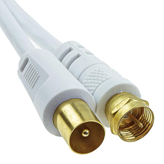

A better connection can be made by removing the Belling Lee on the cable and junk the Belling Lee to F-Type adapter and fit an F-Type straight onto the coax cable.
But fitting a new F-Type cable terminal depends on the size/suitability of your existing coax wire.
There’s a huge number of readymade cables from all the usual web vendors.

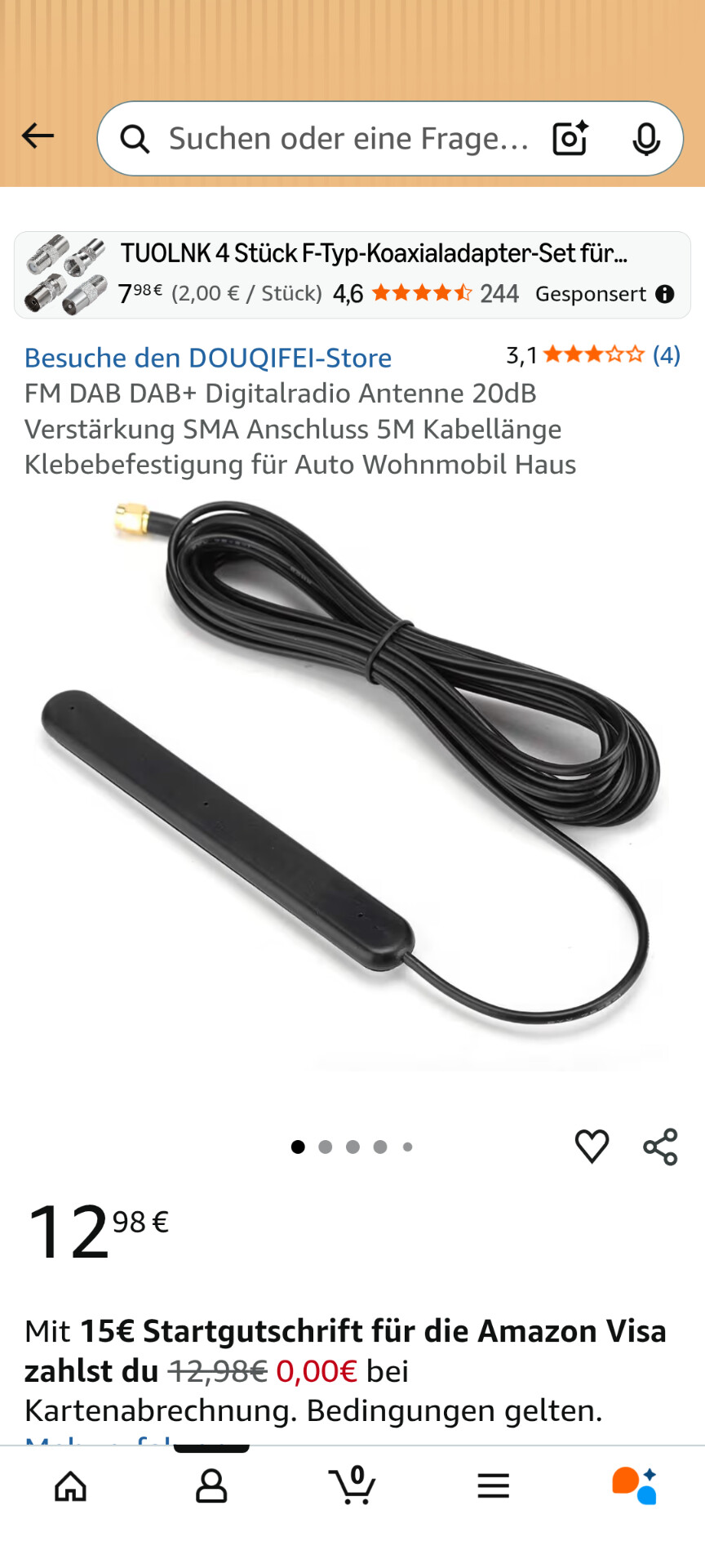

So I added this antenna. I had to add also an adapter, as this has the car SMA connector, but it works like a charm. Thx !
