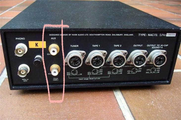

I believe all of the NAC72s that had these Aux inputs were BNC, not RCA. However, it could have been modifies at some point to RCA and, if not, you can use RCA to BNC adapters.
In my Nac 72 there is also an rca entrance
Like this?
:+1:t3:
