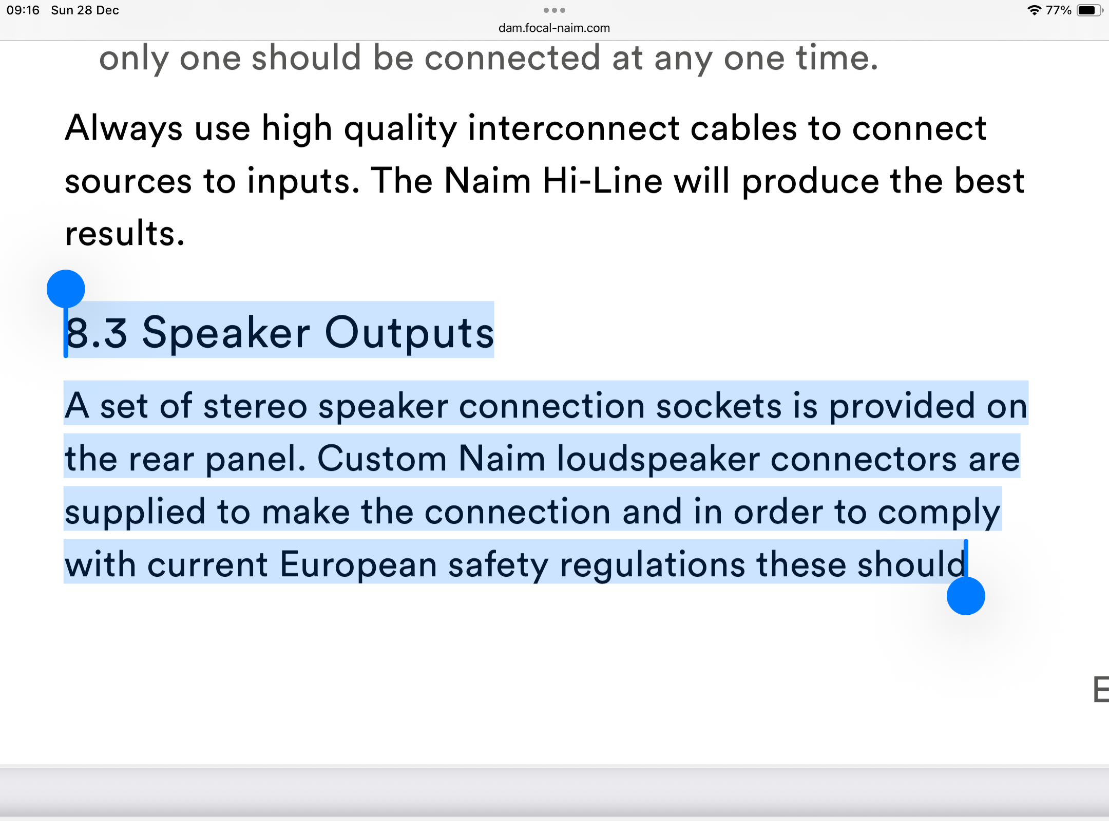

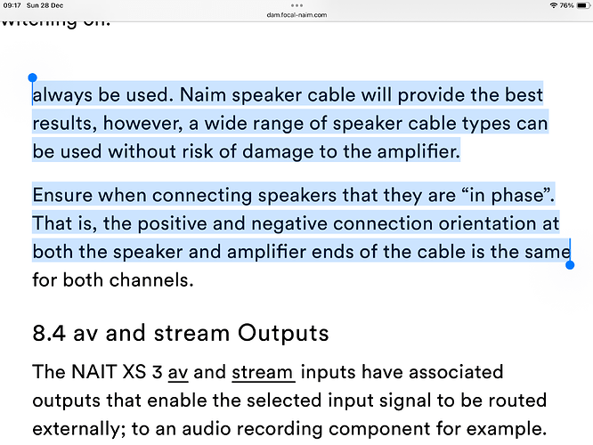

Is this still the case with the XS3? The following is from the (presumably the most up-to-date) owner’s manual on the Naim website:
No mention is made of the minimum lengths or cable specs. I currently use K20 with an XS3 - the length is circa 2.5 metres per side. I do toy with buying up to 5m per side if it would be of any benefit? I couldn’t justify that length of A5 financially - my wife would be furious.

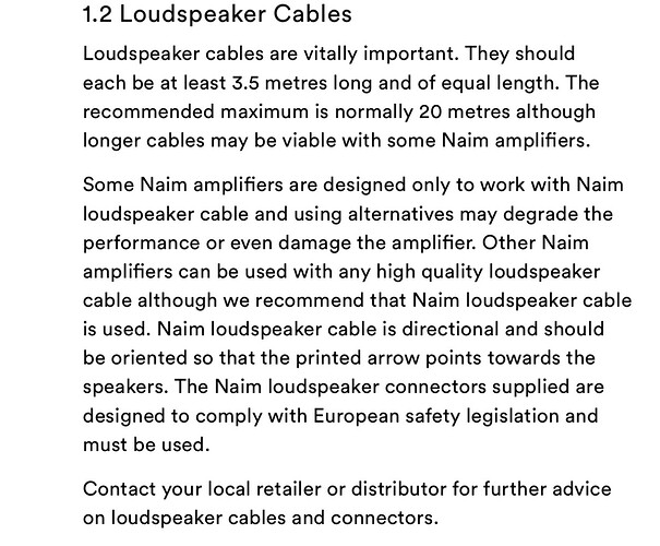

The Nait XS3 manual includes this on page 1.
Many thanks - goodness knows how I missed that!

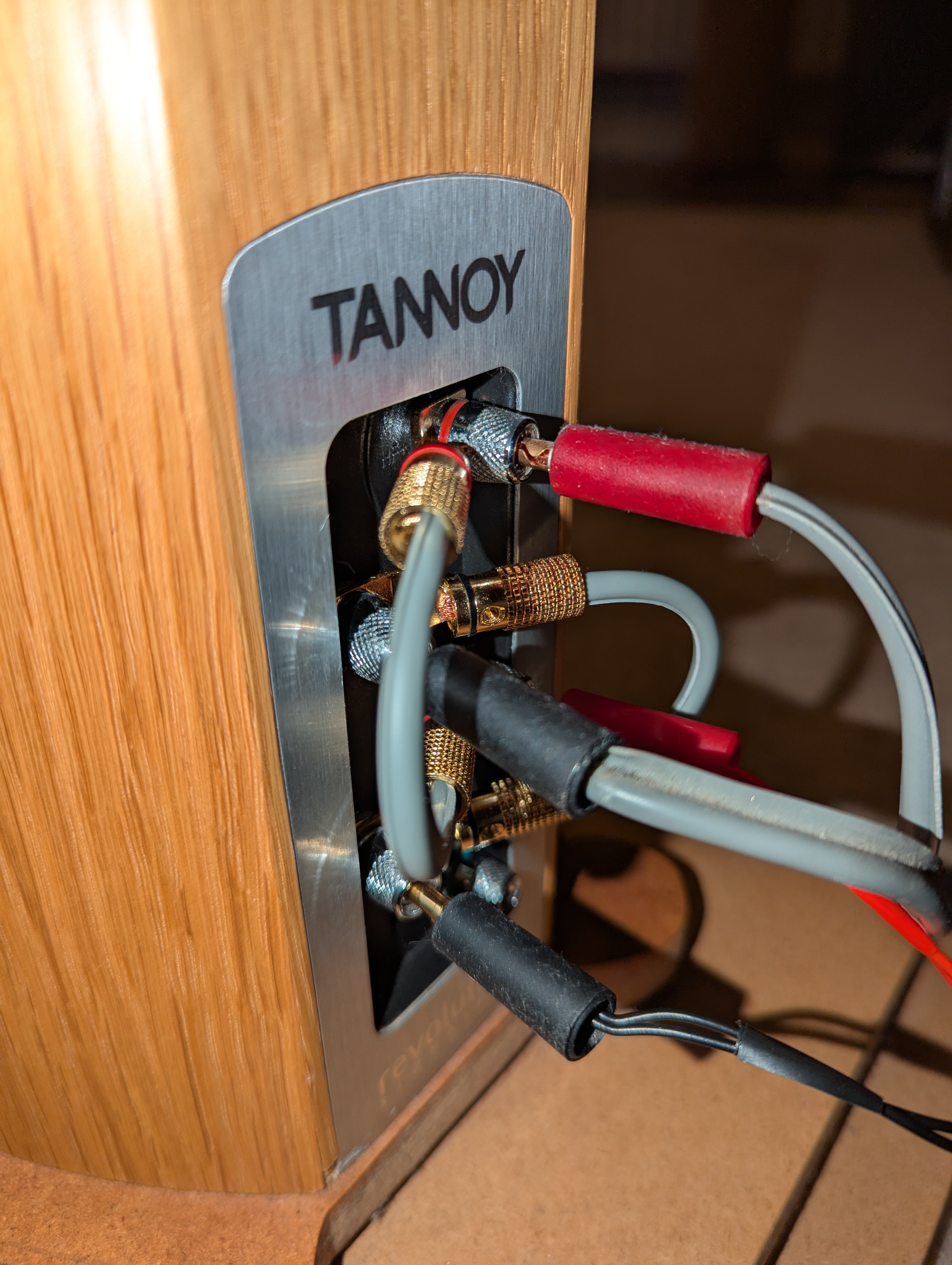

For completeness, at the speaker end I also have 2 X 5 metre BK/REL type bare wire to Neutrik connectors running to 2 active BK subwoofers per side (high level). Other than the effect of the subs themselves, would this also have an effect?
Of the sub cables are run from the loudspeakers, not the amp, they will have no effect on the amp output, so you’ll be fine.

Yes off the speaker end. Like this - sorry it’s not overly clear.
