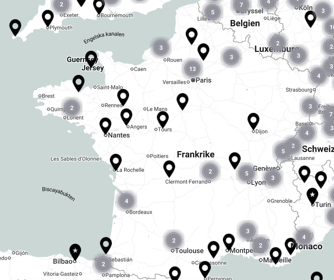

Go to Naims web page and “Our stores” upper right. Then choose your country. Forget the list since it doesn’t show the full retail list and point at the map and you’ll find Naim retailers that can sell you NACA5.

Thks but In France expensive.

Naim dealers and distributors (and eBay) should be able to set you up with a new set.
Even in France, Naim is owned by a French company…
