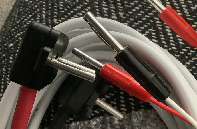

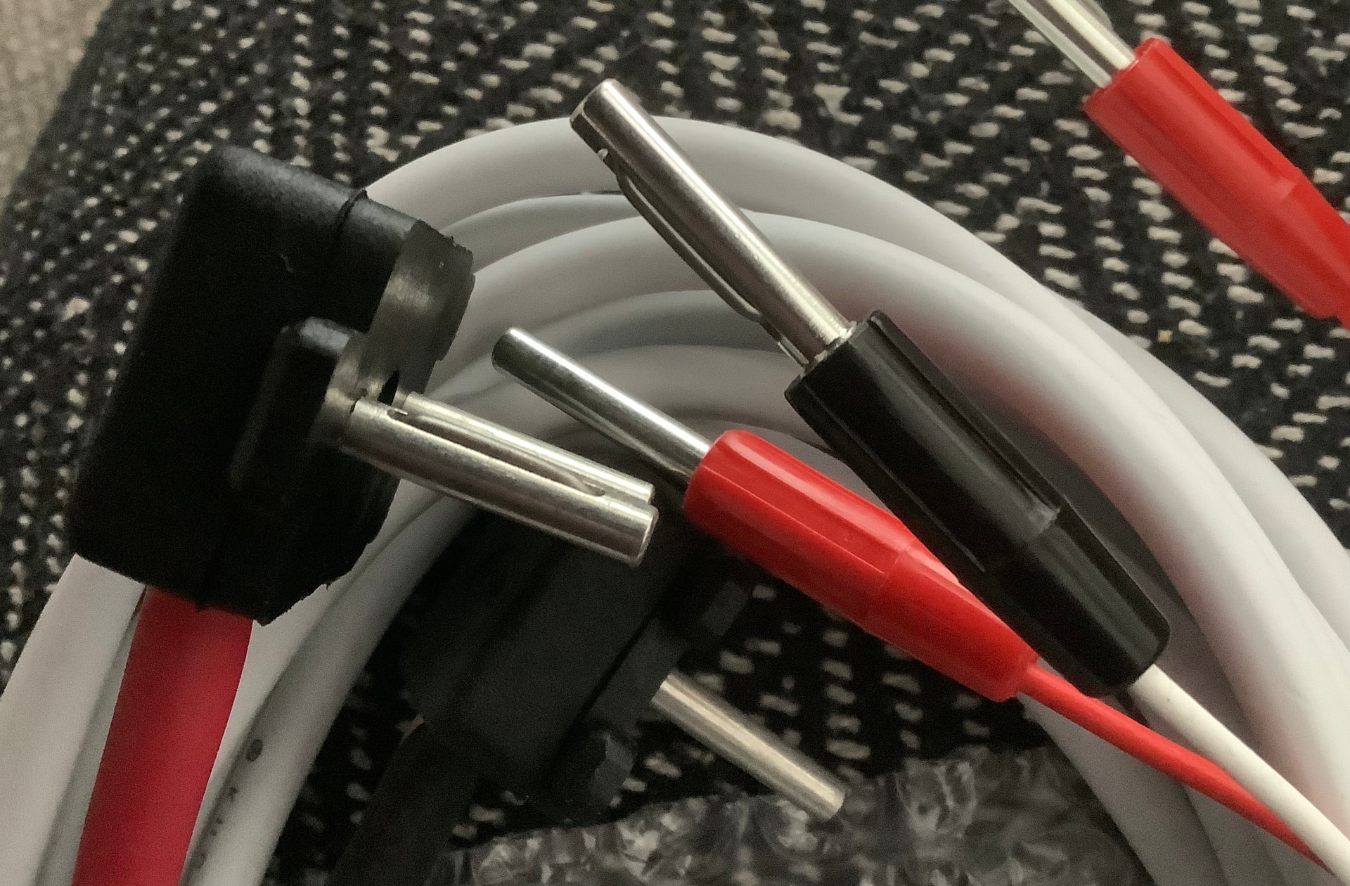

The Naim SA8 Plugs are the best fit but realistically any 4mm banana plugs will do. :+1:
I have SA8 plugs on the amp end and Deltron plugs on the speaker end.
Naim supply the plugs with the amp when new, but they often go missing or are retained by the seller. They are good plugs in most situations, but Deltron also make good nickel plated plugs that would work well. (I have a strong suspicion that Naim plugs are made by Deltron; they look suspiciously similar apart from the right angled solder arrangement.)
The Naim plugs are very good, but I find that the right angled arrangement is only suitable if there is free space behind the amp for the cables to hang vertically down. Shelves often protrude behind the amp, so that the cables sits better if regular plugs like Deltrons are used.
Some Naim dealers are very good at soldering speaker cables. Others, unfortunately, are not. One option is to buy a set of factory terminated Naim cables - they often crop up on eBay. Either that or find someone who knows how to do it properly: soldering really is the best option.
I’ve used Nakamichi connectors on the Nait 5i, Uniti, and Supernait. They’ve always worked great on every device. They feature double-screw clamping directly onto the bare cable.
Welcome to the forum, and congratulations on the excellent purchase.
Thanks for the advice, I did indeed find a pair of used speaker cables that have the Naim SA8 tandem plugs soldered on there already.
The cables are Linn k20 but from what I read they are suitable for Naim Amps.
Yes, they are similar to the previous NACA4.
